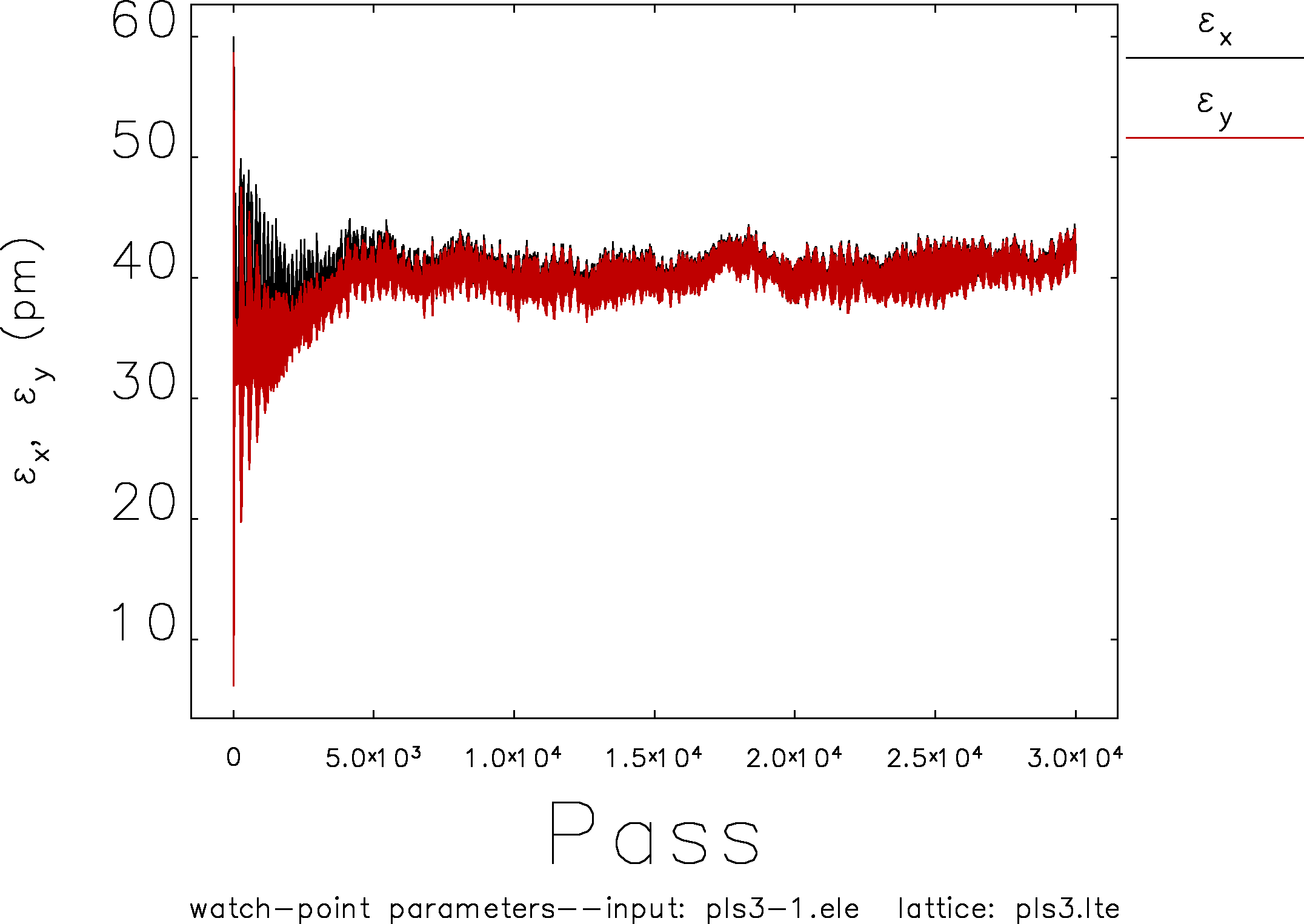

However. the result that we get from your reply reveals that the both of horizontal and vertical emittances become 59 pm the natural emittance of our ring after sufficient turns. Round beam emittance in our lattice is 39 pm.
We tried to remove all skew quadrupoles and put tilt error to normal quadrupoles with gaussian random number.
We set a amplitude of tilt errors as 0.5 mrad.
Then we track beam and verified that the both of horizontal and vertical emittance converge to about 39pm, i.e. round beam emittance.
We attched ppt file with detailed description.
And we attched ele and lte files that tilt errors in normal quadrupoles was put and H and V emittance become 39 pm.
please refer the attached files.
Sincerely,
Gyeongsu Jang

Post by michael_borland » 25 Feb 2021, 14:26
Gyeongsu,
I found a number of problems in the files. I still see SREFFECTS elements and don't see SYNCH_RAD=1 and ISR=1 on the CSBENDS, KQUADs, and KSEXTs. Also, several skew quads are powered at the same K1, which excites the zeroth harmonic instead of the coupling harrmonic. This increases the vertical dispersion without coupling emittance. This is confirmed by the output of the moments_output command and tracking.
Note that even if you add errors to the skew quad strengths, this existing zeroth harmonic may dominate. Errors are by defaulted *added* to the values, rather than replacing them.
Here's what I get with all the skew quads at zero
I've fixed these problems and also created an example of driving the coupling harmonic, which is attached. Results are as expected
2021-02-25.zip
(13.41 MiB) Downloaded 743 times
