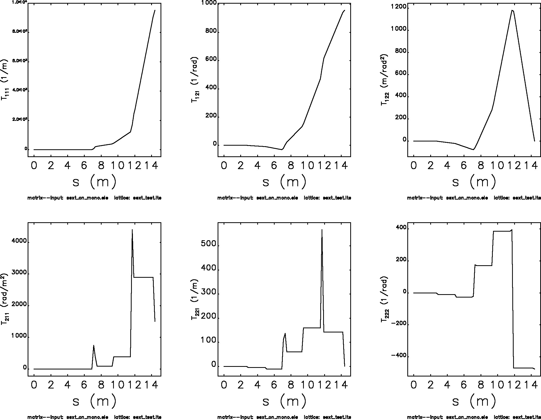

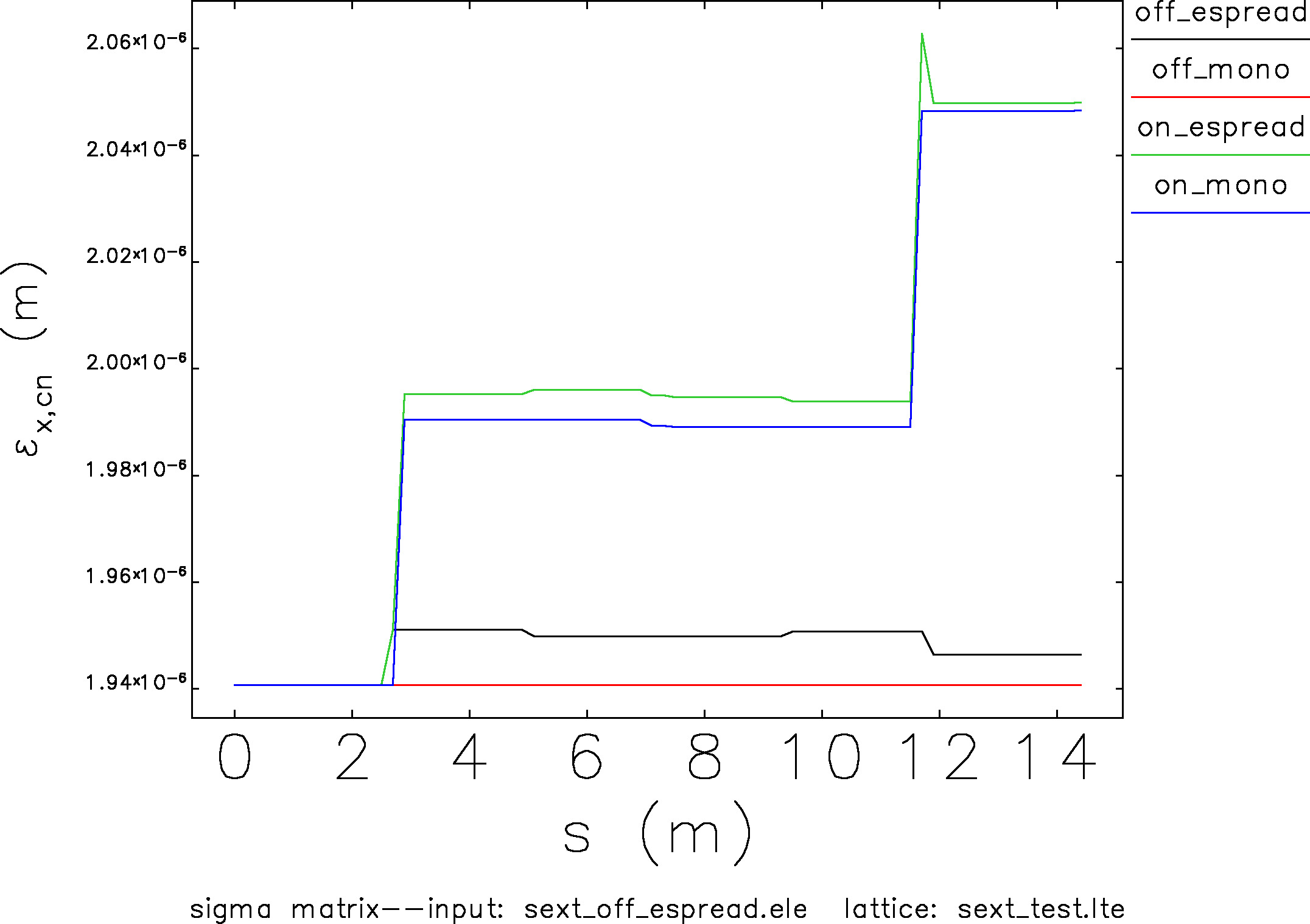

I don't see a huge difference between the cases with and without energy spread. When the sextupoles are on, I do see a noticeable increase in emittance. I guess this is from the T111 matrix element, which becomes very large when the sextupoles are on.

As a matter of fact, I checked with the energy spread of 0.1 % and 1 %, and there was significant reduction of the emittance increasing.
Anyhow, following your analysis, I think I will have to take a closer look at the second order matrix variation with energy spread // and large beta function to understand why the sextupole magnet does not work well with small beta function and low energy spread (if it is natural situation...).
