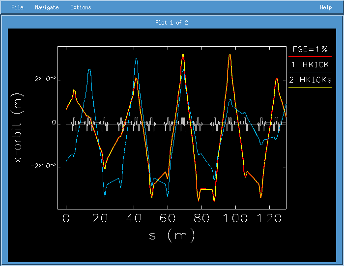

I guess the effect of corrector length should be important if there is some significant betatron phase advance along that steering element.
I've found a simple workaround: the effect of FSE in a bend can be replaced with two HKICKs at the beginning and at the end of the magnet. For a coasting beam (fixed_length=0) the resulting closed orbit will differ from the exact solution only inside the bend -- that will actually produce some small path length error and for a bunched beam in a small ring can be taken into account as well.
Here is the expression for the required HKICK values:
HKICK1 = HKICK2 = -(FSE/(R*sqrt(K)))*( 1-cos(L*sqrt(K)) )/sin(L*sqrt(K)),
where K = K1 + 1/R^2, R -- bending radius, L-- bend length, K1 -- quadrupole component.
- APS.tar.gz
- 1 KICK vs 2 KICK approximation for BEND.FSE in the APS
- (568.61 KiB) Downloaded 1044 times
