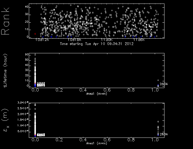

I have tried to used MOGA optimizer to optimize beam emittace and DA.
I found some problem with the DA calculation process in "processJob" script which integrate the clipped area.
It give abnormal large area when the unclipped area is zero. Those with the large area have DA like this: I tried to solve this problem by adding a line in the script:
-redefine=column,Area1, Area 0 == ? 0 : Area1 $ " \
this seem to solve the problem. However is there a better way to this?
And I wonder why the calculation gives the wrong values in the first place?

- Posts: 2059
Re: MOGA optimizer for rings
Thapakron,
I wonder if you are using a very old version of elegant? The problem with getting very large area when the area is actually zero was solved several releases ago (I thought). If not, perhaps you can post the files for one of these cases.
The problem with FMA near the y=0 plane is due to cross-plane coupling. When the y value is very small, the motion coupled from the x plane can produce complex motion that doesn't have an unique, easily-identified frequency. The best thing to do is ignore the data for small y. You can change the input file to increase ymin in the &frequency_map command, or just filter the data after the fact.
Hi Michael
The Area obtained from Elegant is correct (zero when there is no aperture).
But during the clipped Area (Area1) calculation by the script "processJob", it gives
some large constant value for example ***
Area_check :0.000000000000000e+00 (from .aper)
Area1_check:1.005000000000000e+00 (after processing) ***
On the other hand, when the Area is non-zero the clipped area (Area1) can be calculated correctly:
Area_check :1.125074645767331e-04 (from .aper)
Area1_check:7.669601360507396e-05 (after processing) ***
you can see from attached script.
Thanks a lot
Thapakron
