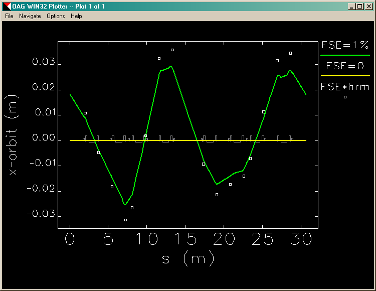

Dear Michael,
I think there is a bug in the correction_matrix_output command then BEND.FSE is used as steering element. Closed_orbit command gives a different result.
Please take a look at this example script.
I would like to use BEND.FSE in a response matrix fitting. Is it supposed to be used that way? We have a horizontal correction as additional coil in 45-degree dipoles.
Thanks,
Alexey.

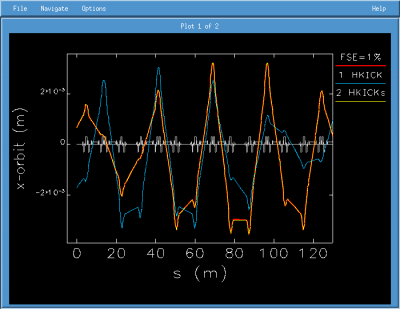

I guess the effect of corrector length should be important if there is some significant betatron phase advance along that steering element.
I've found a simple workaround: the effect of FSE in a bend can be replaced with two HKICKs at the beginning and at the end of the magnet. For a coasting beam (fixed_length=0) the resulting closed orbit will differ from the exact solution only inside the bend -- that will actually produce some small path length error and for a bunched beam in a small ring can be taken into account as well.
Here is the expression for the required HKICK values:
HKICK1 = HKICK2 = -(FSE/(R*sqrt(K)))*( 1-cos(L*sqrt(K)) )/sin(L*sqrt(K)),
where K = K1 + 1/R^2, R -- bending radius, L-- bend length, K1 -- quadrupole component.
APS.tar.gz
1 KICK vs 2 KICK approximation for BEND.FSE in the APS
(568.61 KiB) Downloaded 1042 times
