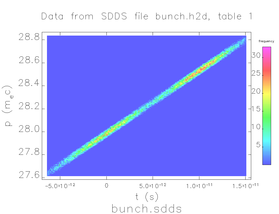

I'm not sure what the problem might be. Everything looks ok to me. The bunch.sdds file has one page, as expected, with two sub-bunches.
This can be seen clearly by doing
% sddshist2d bunch.sdds bunch.h2d -col=t,p -xparam=200 -yparam=200
% sddscontour -shade bunch.h2d
A similar plot for A0_Xchgr.XProbe also looks fine.
2d histogram of A0_Xchgr.XProbe (t, p).
2d histogram of bunch.sdds (t, p)

Dear Michael,
Can you please send me the bunch.sdds file? (that you generated on your machine). Thanks
regards,
Charles
[When i run the commands above i get a totally different plot]
