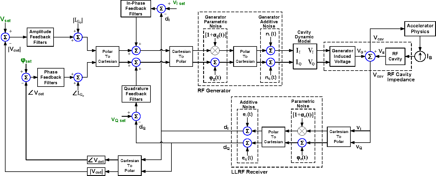

The rf feedback model diagram (which is supposed to appear in the manual on line but doesn't for some reason) shows how "noise" can be injected into the loops. In reality, this feature allows injection of signals of any type at various points in the loops. I think you could use this to modulate the generator current, generator phase, voltage setpoint, and phase setpoint. Since you need to do this bunch-by-bunch, the feedback update interval should be equal to the bunch interval.
That's an interesting idea. We plan to deal with this problem by making the bunches on either side of the gap higher in intensity. It seems to work well in simulations, but of course the high-intensity bunches will have shorter lifetime.
