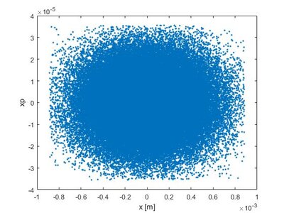

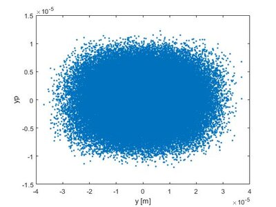

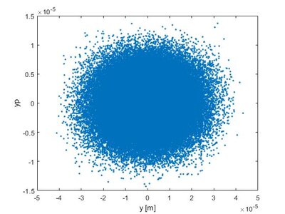

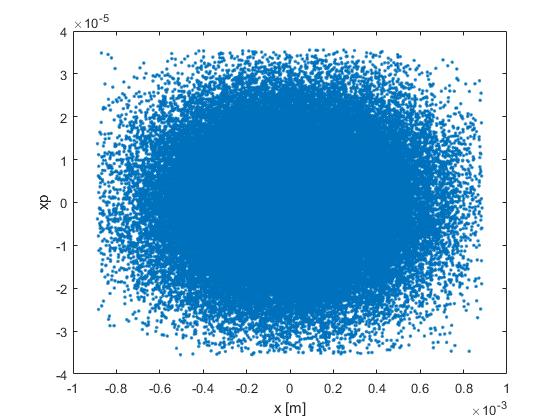

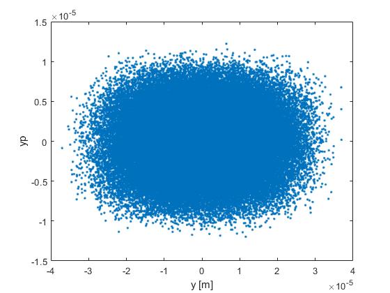

As shown in the attached example, I want to use the moments_output file to generate the particle distribution by set the parameter use_moments_output_values=1 in bunched_beam. I first checked the emittance of the generated particles by using sddsanalyzebeam command, the results is ex/ey=3.387026652738970e-09/4.106160920677630e-11,while the e1 & e2 value in mom file is 2.633363e-09/3.048417e-11.The emittance values are not exactly equal, but close. When I further check the phase space distribution,the x-phase space is not Gaussian,is there something wrong?

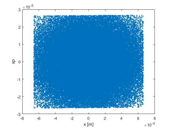

I think I've found the reason for the strange distribution of particles in the x direction. I want to generate three sigma cutoff Gaussian particle distribution, I should set the distribution_cutoff parameter, not the enforce_rms_values parameter. When I set distribution_cutoff[0] = 3*3,the particle distribution is as shown in the attachment.
But the sddsanalyzebeam command gives the ex/ey parameters still doesn't match the e1/e2 parameters in mom file.
