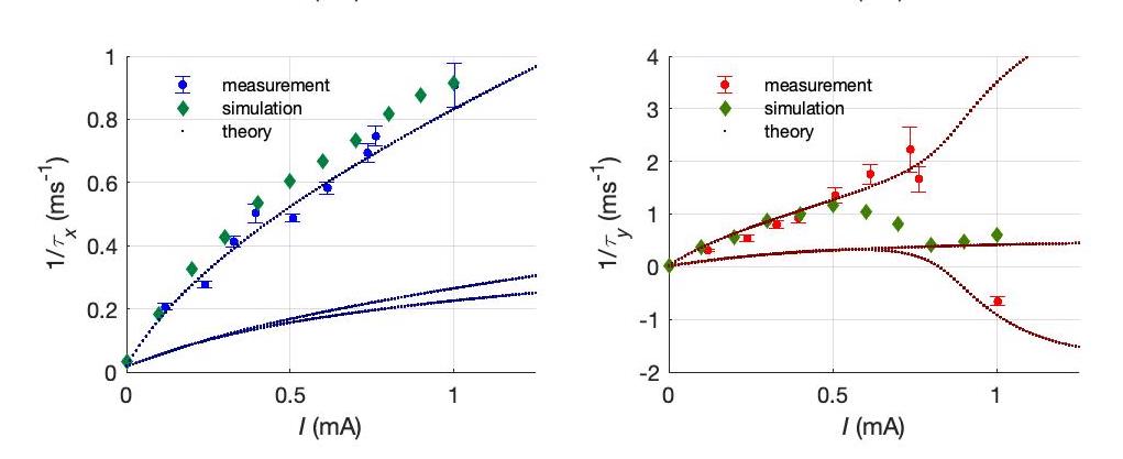

Hi Michael,
We are facing the discrepancy between the measurements and simulations in the vertical plane while studying the head-tail instability for NSLS-II. We use the equilibrium bunch length for a particular beam current and then add 0.1mm transverse kick. Strangely, we also need a very high shunt resistance in the vertical plane to fit the experimental data.
We see the same behavior with feedback in the vertical plane.
I’ve attached the files for your reference. Can you please check what might be the reason?
Here is the damping rate comparsion b/w measurements and simulations.

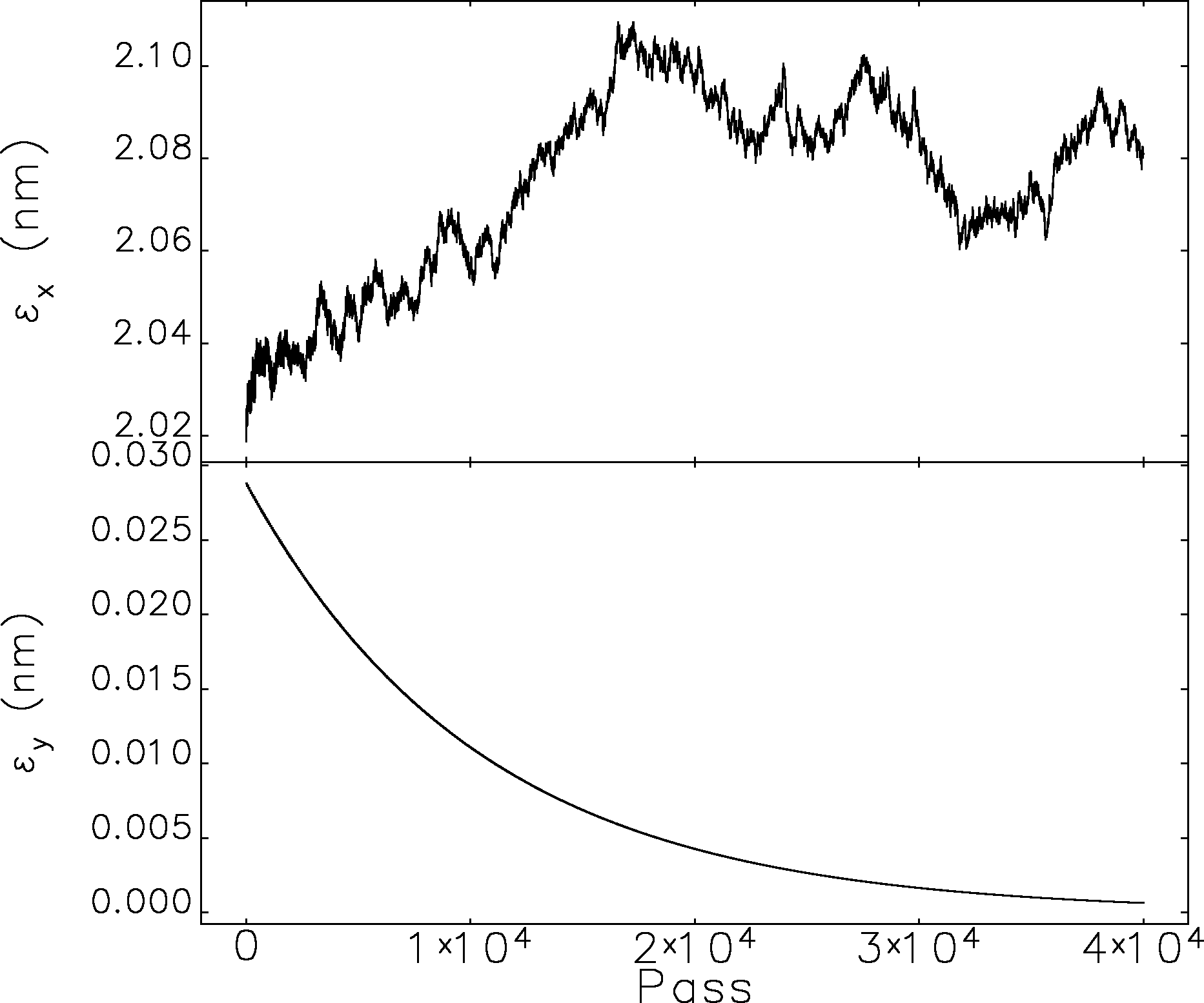

Post by michael_borland » 21 Apr 2021, 17:04
Aamna,
The damping time is 20,000 turns, so you would need to track longer to see equilibrium. Here, for example, is 40,000 turn tracking with no coupling and charge=0. The vertical emittance is trending to zero as expected.

Thank you for your response, Michael.
I still don't see the equlibrium beam size for coupling lattice. The initial bunch size using the average beta function of 13.8m for emittance = 30pm is ~20 microns, but ILMATRIX gives betay = 3.366872m. How does elegant compute the initial vertical distribution from the vertical emittance in this case?
We want to compare the elegant results with internal code SPACE. We obtain the following results:
In SPACE, before the dipole kick at 10k turns, the bunch is in equilibrium.
After the kick, the bunch centroid envelope decays with a damping time equal to the radiation damping time (54ms), while the bunch size envelope (substracting the equilibrium value) decays with a damping time equal to half the radiation damping time (27ms).
Please correct me, if I'm interpreting/doing something wrong.

Aamna,
The initial distribution is prepared using the lattice functions at the beginning of the lattice, since that is where the beam starts. Since you are looking at data from a WATCH element, elegant should provide data consistent with the lattice functions at the location of the WATCH element. The average beta function does not come into play at all, except insofar as you would need to weight your transverse impedance with it.
Since you didn't say how you are introducing coupling, it is hard for me to comment on that. I see the vertical emittance damp to zero in the uncoupled case.
