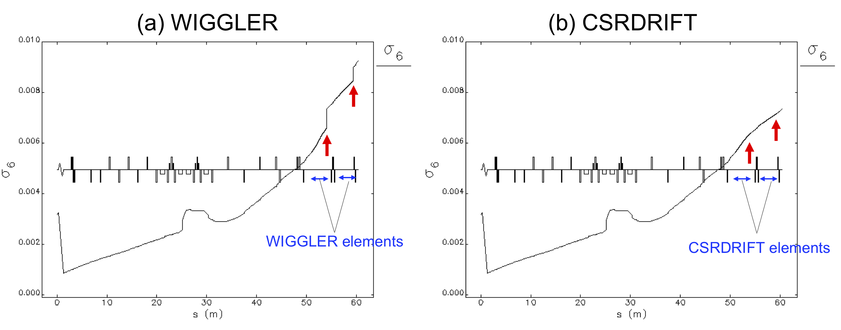

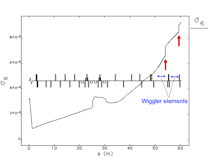

In the attached figure of the momentum spread along the beam path, there are two jumps pointed by red arrows.
Both jumps occur at L12 elements (CSRDRIFT elements with LSC on) just after two undulators made of WIGGLER
elements(UND0) and LSCDRIFT elements having the same effective length (LSCUND), which are defined below.
UND0: WIGGLER,L=0.024,K=1.421,POLES=2
LSCUND: LSCDRIFT,LEFFECTIVE=0.024,BINS=100
When I replaced one of the L12 elements with an LSCDRIFT element LL12, the sudden jump of the momentum spread
disappeared at LL12 and such a jump appeared at the CSRDRIFT element just after LL12 instead of LL12.
I cannot understand why these jumps of the momentum spread appear at CSRDRIFTs just after WIGGLER elements.
Please let me know the reason.

Norio,
The reason for this is that CSRDRIFT tries to compensate for the missing effect of CSR in elements that don't explicitly model CSR. In drifts, most of the effect is on the longitudinal plane, so CSRDRIFT back-drifts to the end of the last CSRDRIFT or CSRCSBEND, then integrates forward. In this way, one can include CSR effects in straight beamlines even if they have other components besides CSRDRIFT.

I replaced WIGGLER (or CWIGGLER) elements with CSRDRIFT elements.
The simulation results are shown In the attached figure of the momentum
spread along the beam path.
Fig. (a) is for the WIGGLER case and Fig. (b) is for the CSRDRIFT case.
In Fig. (a), there are two jumps pointed by red arrows at a CSRDRIFT element
just after the WIGGLER elements as I said in the previous mail, while in Fig. (b)
there are no jump. The two energy spreads are clearly different at the end of
the beamline. The WIGGLER elements seem to affect the momentum spread.
Please let me know the reason if you know. Thank you in advance.

Re: CSRDRIFT after WIGGLER element
Norio,
I think the problem is that you are including LSC, which depends on the beam size. When elegant gets to the end of the wiggler, it adds in all the "missing" CSR and LSC. Since the beam sizes are very different in the case with and without the wiggler, you get different longitudinal wakes from LSC.
When I disabled LSC, the two runs were nearly identical.
