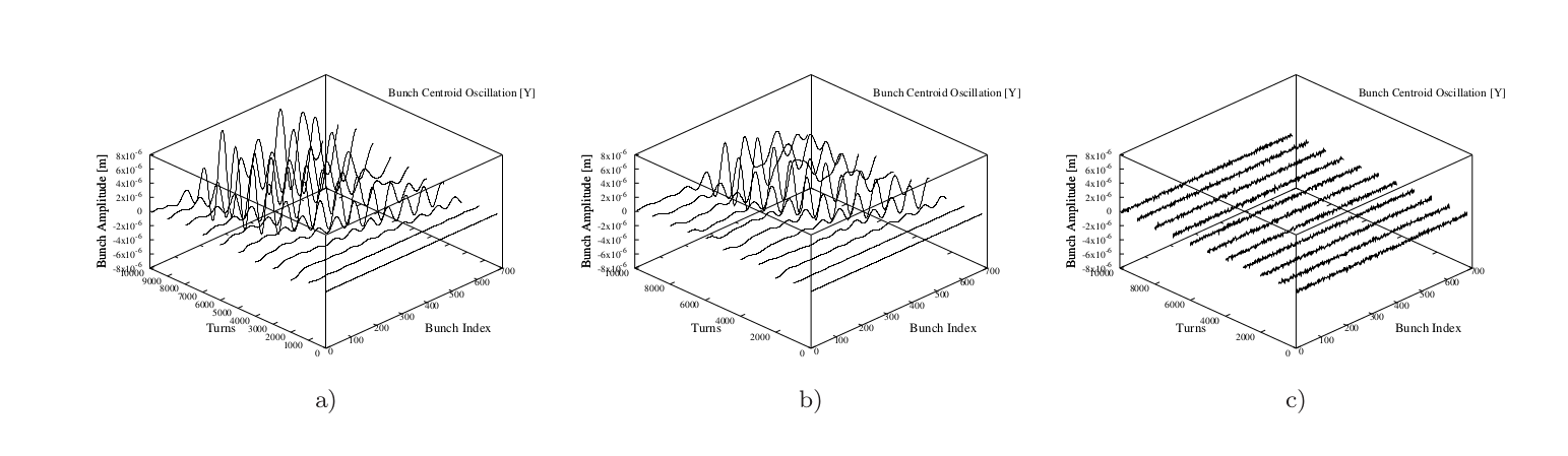

The attached files shows 3 sub figures, the a) and b) are the beam centre oscillation as functions of turns with and w/o synchrotron radiation damping respectively, the weak-strong model is applied; c) is obtained with "quasi-strong-strong" simulation and the synchrotron radiation is turns on. Other condition as filling pattern, beam current, and lattice are the same.
As seen, I am surprised that the "strong-strong" does not give me any bunch oscillation information. Compared with the weak-strong simulation, almost nothing useful is given.
Since I am really new in this field and do not have too much experience on the beam-ion interaction simulation, I am really wandering what would be the case for the "strong-strong" results? Should be similar to the subfig b), but with a much smaller oscillation amplitude ?

Have spend a lot of time to debug the code (during the last several weeks), and suddenly I have realized the problem in the beam-ion effect simulation with the "quesi-strong-strong' model.
It is discussed by several researchers that the ions distribution will not with a Gaussian type, where as in the original model in simulation, we still assume that the ions follow the Gaussian type, and the rms values of the ions are used in Bastine formula to get the E force from ion to electron particles. Usually the accumulated ions will not be lost till reach the beam pipe, where the pipe size is much larger that the rms beam size. In this case, the rms size of ion distribution is also large, which gives very tiny effect on electron particles.
At this moment, I have made some test code running, where the ion loss criteria is changed to several rms beam size (in my simulation it is chosen as 4 rms beam size, beyond which the ions are erased). The results of the "quasi-strong-strong" model right now give bunch oscillation information.
I think I am getting a feeling why new fitting process of ion density is now adopted in elegant. However still since the non-self-consistent process, I am worrying that the, even with a better fitting curves, criticism of the non-self-consisten will be still there. It probably have to go further to a ion "Poisson solver", like PIC approach.

Sorry for not responding to your earlier message. The strong-strong simulation is very challenging and it is fair to say that we are not satisfied with the results we are getting in elegant using the new fitting-based methods. In addition to being quite slow, they seem to predict instability when we don't observe an instability in the actual machine. Noise is suspected, but it is hard to suppress even when the number of ions is very large.
Our concern about a poisson solver is that it will have similar noise issues. My colleague Ryan Lindberg points out that the bi/tri-gaussian/lorentzian fitting functions we are using should filter noise fairly effectively, whereas a Poisson solver might not be as good unless the grid is sparse.
