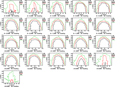

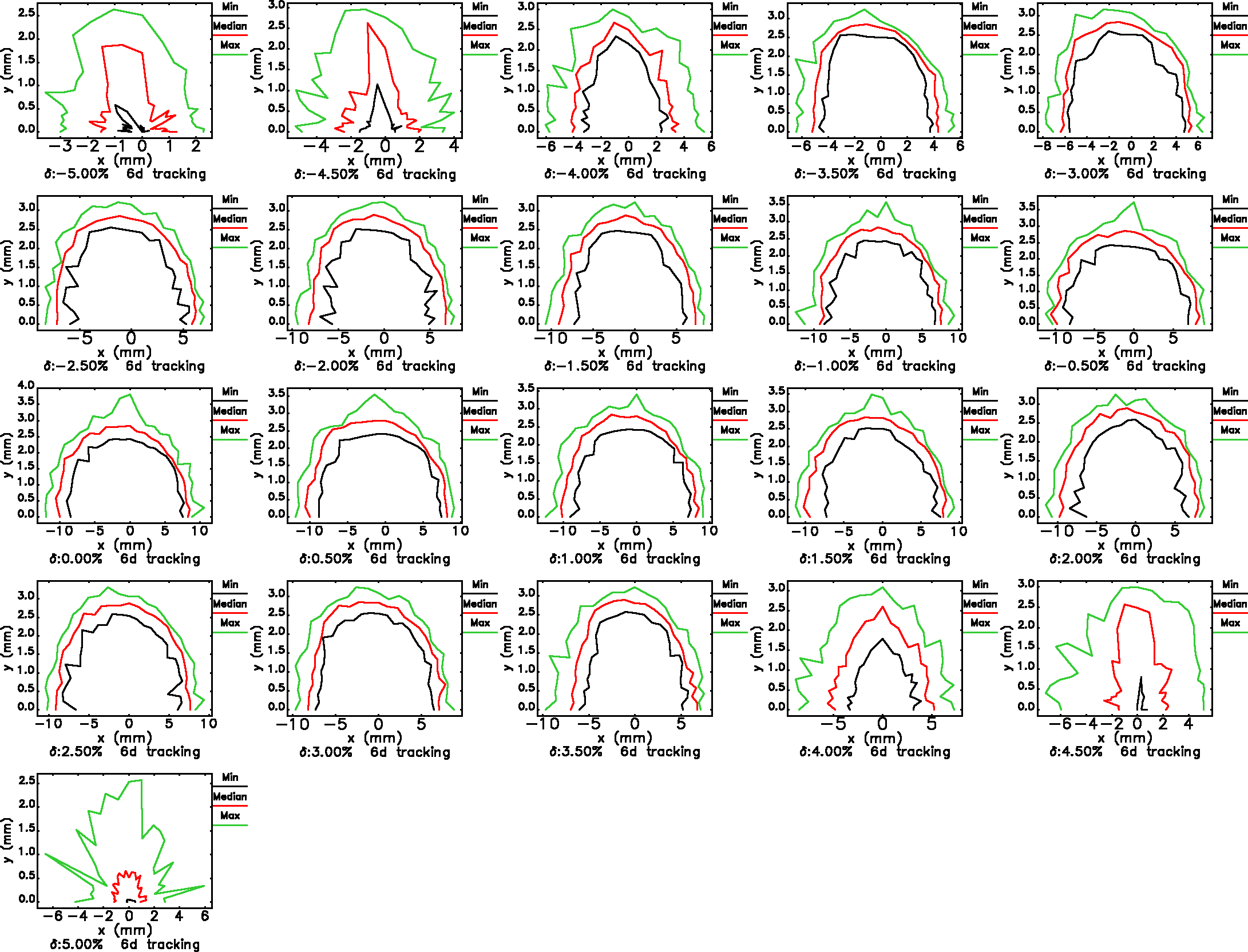

The basic problem is that when one adds errors to lattices with strong sextupoles, the tunes may change significantly or the closed orbit may not exist. It's necessary to start with the sextupoles turned off, then ramp them up to full strength while correcting the orbit. Once that is done, one can perform DA tracking. There is a Notebook file in the attached zip file that explains the process. The zip file also contains the results of scanning the momentum offset and computing the DA (4d and 6d methods) for 10 seeds.
Here's a sample from 6d tracking (i.e., with rf cavities and damping). --Michael
Sorry for the delayed reply. It took a while to put together an example of how to handle a case like this.
