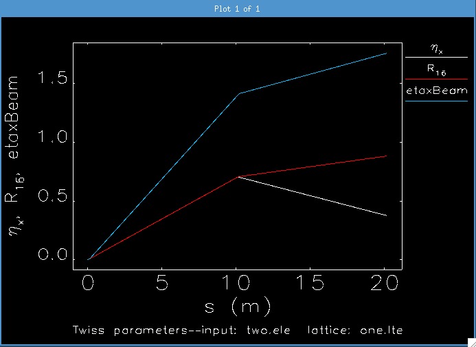

I double checked the simulation results with my calculation with Mathematica using first order matrix. It seems like:
1. when there are no acceleration, e.g. RFCA and RFCW, the R16 from *.mat is same with etax from *.twi, and are also same with etaxBeam calculated by s16/(s6*s6).
2. But when there are acceleration, R16 (*.mat file) will not be equal to etax (*.twi file), but R16 and etaxBeam (s16/(s6*s6)) have the relationship as:
etaxBeam=p2/p1 * R16, etaxpBeam=p2/p1 * R26,
where p1 is the initial energy, p2 is the final energy. But I still don 't understand how etax is gotten ?
3. And I am also confused with the beta function when linac is added in the tracking. There is a paper published in NIM by Hara Toru titled "Transverse envelope analysis for accelerating relativistic electron beams in a linear accelerator as a photon source" in 2010. Dose elegant also use the same convention ?
The elegant input file is attached, I used the lattice layout as {dipole linac drift}, and the above results are got with local_dispersion=1. When I set local_dispersion=0, the etax is 0 along the line, so I still don't understand your words of "Because local_dispersion=1 in twiss_output, you'll see apparent inconsistencies with the transport matrix elements, which are always referenced the the initial coordinates."

It appears that twiss_output gives wrong results when there is acceleration in a region of high dispersion. If you have a sequence like "linac-bunchCompressor-linac-bunchCompressor..." the results should be fine.
The R16 value (from matrix_output) and the effective dispersion (computed from the sigma values) are correct, but they will differ. The former is just the matrix element from the beginning of the transport line, while the latter is referenced to the local energy spread. In an isochronous system, they'll be related by the ratio of the initial to final momentum. However, if there is momentum-dependent variation in path length from a bunch compressor followed by additional off-crest acceleration, this isn't assured.
