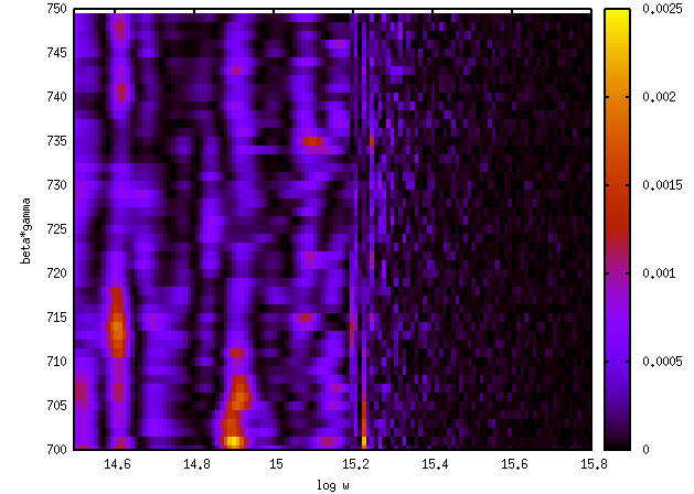

I meant a different thing. If I compute bunching factor and plot it versus energy, I persistently see a cut-off at a given frequency (see attached). This exists with both LSC on and off and also does not change for different bunch parameters. To me it looks like there is a limiting low-pass filter of some sort or round-off issue. By the way, does elegant use full 64-bit double precision everywhere? Can you please comment on this?
Here is the script I am using to generate data file for the plot attached.
Thank you for your time!

I made another scan for higher beta*gamma values to further illustrate the issue.

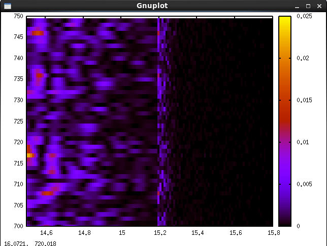

Post by headdoggy64 » 30 Mar 2015, 16:57
Michael,
Thanks for the reply!
I included these lines in my bunched_beam section
Code: Select all
  halton_sequence[0] = 1,
  halton_sequence[1] = 1,
  halton_sequence[2] = 1,
and ran the same configuration again. I am still running into the issue.
Can this come from the implementation of the longitudinal space-charge algorithm?
Is the wavenumber k in the impedance Z(k) limited from above by some large value?
Thanks for your help!
P.S. The plot represents the bunching factor n(w). Y-axis is beta*gamma and X-axis is log w.

Post by michael_borland » 30 Mar 2015, 17:10
Alex,
I think you need to give a few more parameters for the Halton sequence to work. I suggest adding
Code: Select all
	symmetrize = 0,
        enforce_rms_values[2]    = 0
        halton_radix[4] = 2,3
        optimized_halton = 1
This isn't going to cure the problem but may extend the smooth region of the spectrum out to slightly higher frequencies.
