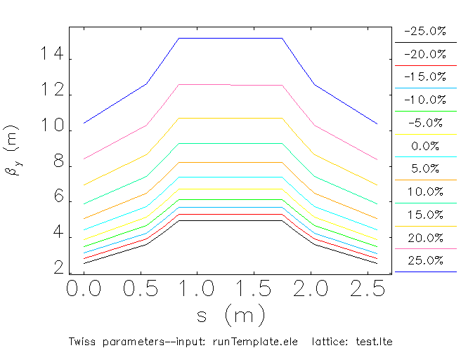

Here's an example using your lattice file that shows betax and betay changing with momentum offset.

I traced the code for the example files I sent you and verified that the closed orbit is indeed used. One reason it doesn't matter much seems to be that the whole system is very linear. The bending radius is nearly 300m and there are no sextupoles. I don't expect the orbit to make any significant difference in such a case.
Another way to check this is with tracking. By tracking off-momentum particles and computing, for example, (max(x)-min(x))/(max(xp)-min(xp)), we can determine the beta function. When I do this, I get the close to the same answer as the twiss_output command gives. Given that elegant only has a second-order matrix for the dipole, this is about the best we can expect with such large momentum deviations.
