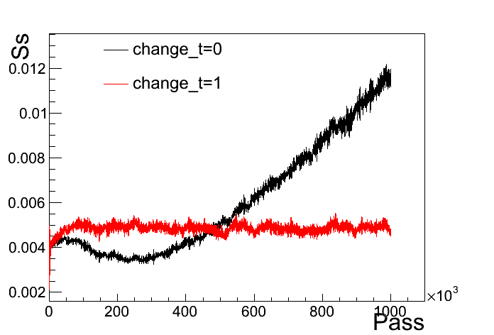

I attached the input files (it is a modification of the PAR/bunchLengthening example). And a plot of sigma_s of the tracking once with change_t set in the cavity and once without. It seems the black curve is the wrong one, is it not?
The thing is, I'd like to look at the bunch length while applying time/turn dependend modulations.

Re: many-turn tracking with time dependent modulations
Martin,
The Ss parameter is often misleading as it doesn't mean what people think it means. It isn't equal to the rms bunch length, but rather the rms spread in effective distance traveled at the instantaneous velocity.
http://www.aps.anl.gov/Accelerator_Syst ... ode13.html
You should use the St parameter, which is the spread in arrival time at the observation point. In that case, I think you'll find the behavior is reasonable for both change_t=0 and 1.
Probably it would be best for everyone's sanity if I just removed Ss or simply redefine it as St*<beta>*c.
Dear Michael,
yes you are absolutly right! I misinterpreted the meaning of s. St is the quantity I wanted and it gives comparable results for both change_t=0 and 1. Thank you for your help!
Martin
Martin
