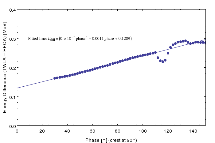

I have come across what seems to be an inconsistency. I've swapped two cavity structures (accelerating from ~70 MeV) and done a phase scan in both. In the first picture all looks ok, the red points are TWLA and the blue points RFCW.
But a closer inspection reveals a puzzler - in the second plot I just take the difference between the two. As you can see it looks like there is a difference depending linearly on phase - up until a phase of 110 degrees. Then it goes wild. Any ideas?
