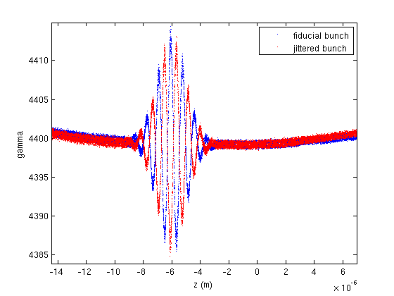

MIchael,
I have been trying to carry out jitter simulations using the LSRMDLTR element, fixing the phase of the laser with respect to the time envelope. To do this I was tracking 2 bunches, the first to act as the fiducial bunch and then apply errors to the linac for the second bunch. When I try this the time envelope remains constant between the two bunches, but the phase of the laser changes. Is there a way to fix the phase? I've attached the .ele and error files I've used as reference, and also a plot showing the longitudinal phase space for the two bunches at the end of the linac.
thanks again,
Ian
thanks again,
Ian
