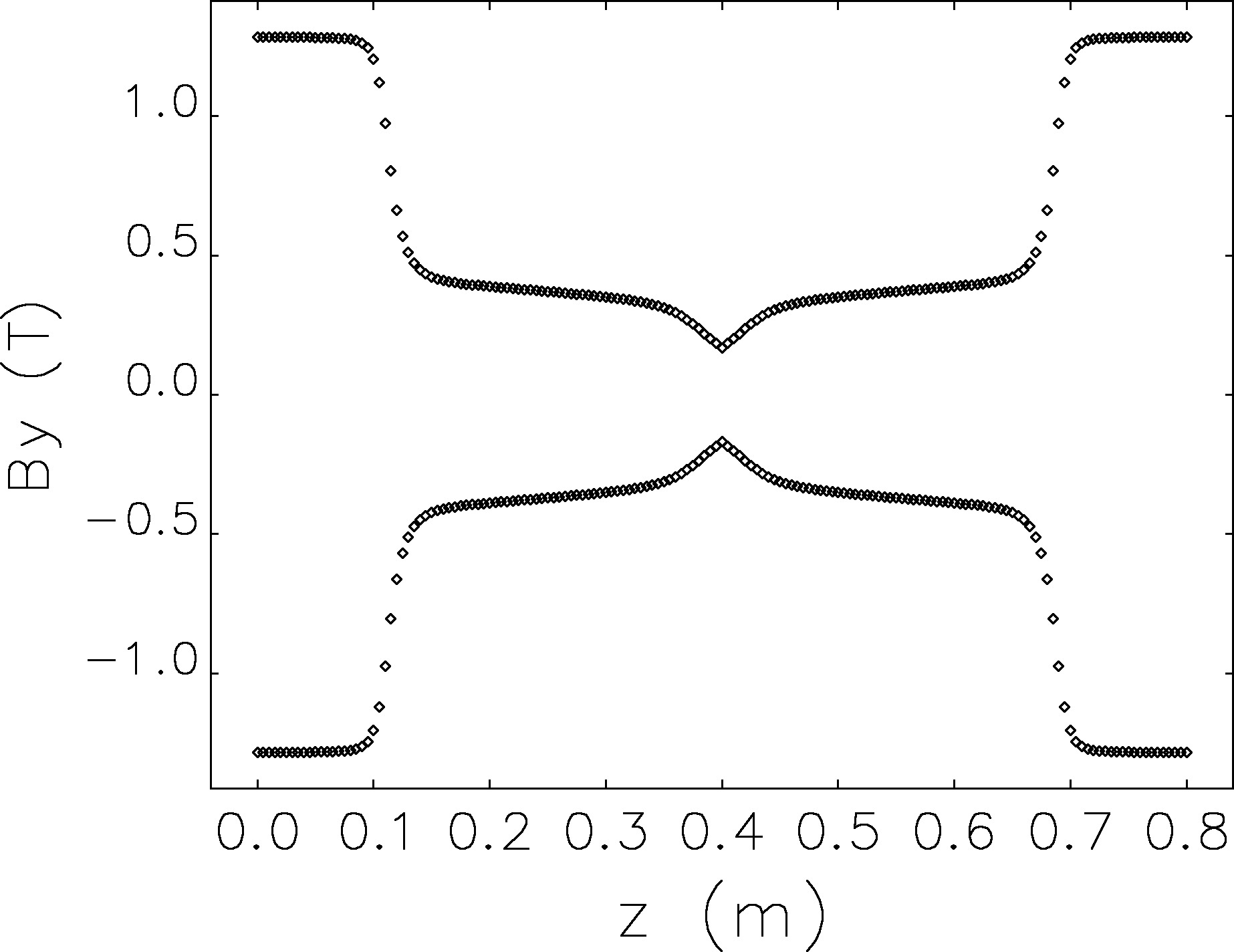

Something is not right in construction of the magnet field map file. For example, if I plot By(x=0,y=0,z) using
I get
Also, if try to plot By(x,y) as a function of z using
I get an error message

Hi Michael, thank you very much for your reply. As you mentioned, there was an issue with the field file. I originally had only 1/4 of the magnet and had to generate the other parts by reflecting the fields across the Y and Z axes, and I made a mistake. Now it looks more regular.
