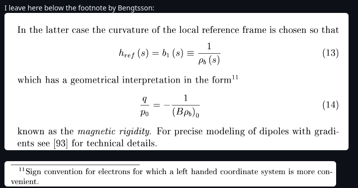

After reading back again Bengtsson I just saw that Bengtsson prefers to derive the equations in a left handed coordinate system, which explains the sign difference between the article equations and the Elegant code.
The code is correct. I leave here below and extract from Bengtsson's article.
Posts: 2057
Joined: 19 May 2008, 09:33
Contact:
Re: Sign of summation in second order RDTs wrt sextupoles
Post by michael_borland » 07 Jul 2026, 10:36
Thanks for letting me know. A left-handed coordinate system is really odd.
