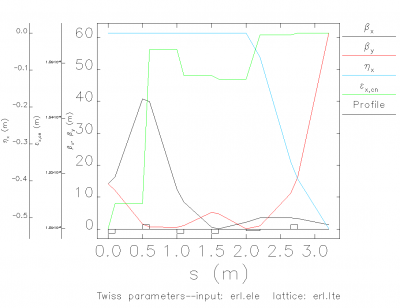

I did a tracking of a simple lattice ,but the normalized emittance changed.Is this a bug? Can you have a look
- twi.png (8.24 KiB) Viewed 8968 times

It's not a bug, but rather a result of the fact that you plotted the uncorrected emittance and have dispersion in the system. The uncorrected emittance is defined as
ex = sqrt{ <x^2> <xp^2> - <x*xp>^2 }
If there is dispersion (e.g., following a dipole magnet), then this quantity can grow.

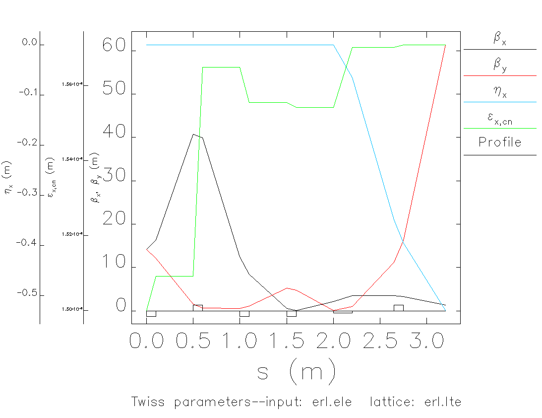

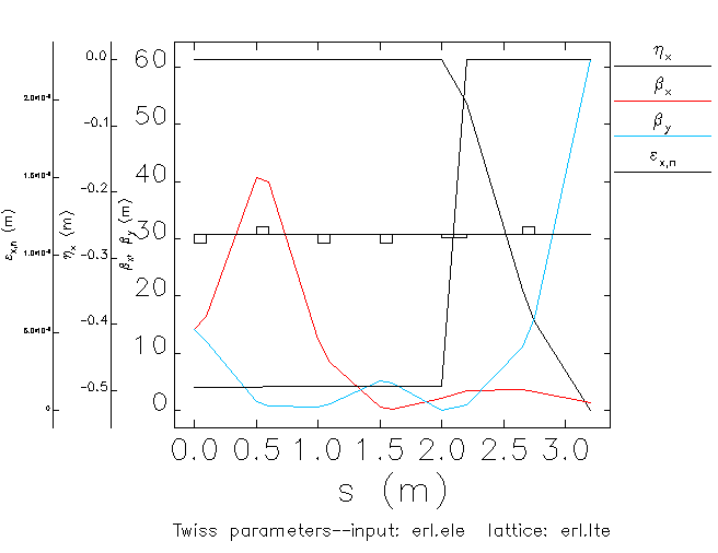

If you plot the corrected emittance (ecx or ecnx), you get a different picture. For the corrected emittance, we make the transformation
x -> x - delta*etax
xp -> xp - delta*etaxp
prior to computing the emittance.
As you can see in the attached plot, ecnx is nearly constant. It isn't exactly constant because of chromatic aberrations from the quadrupoles.
