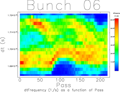

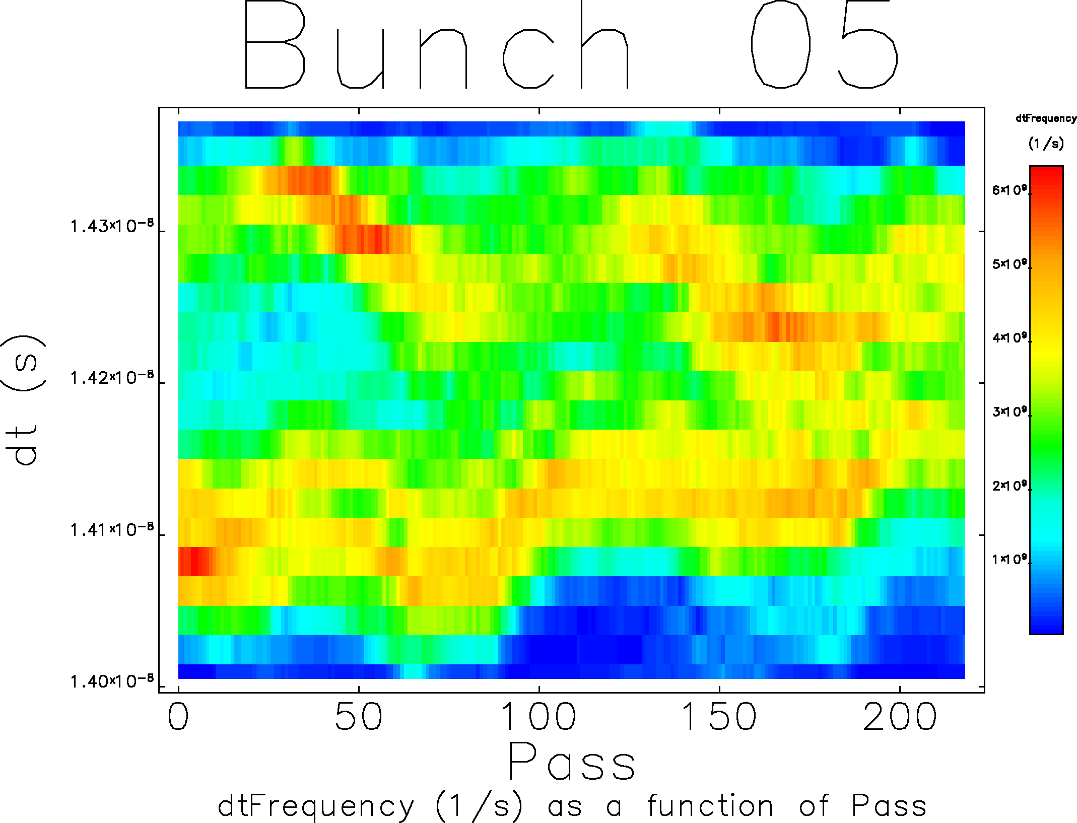

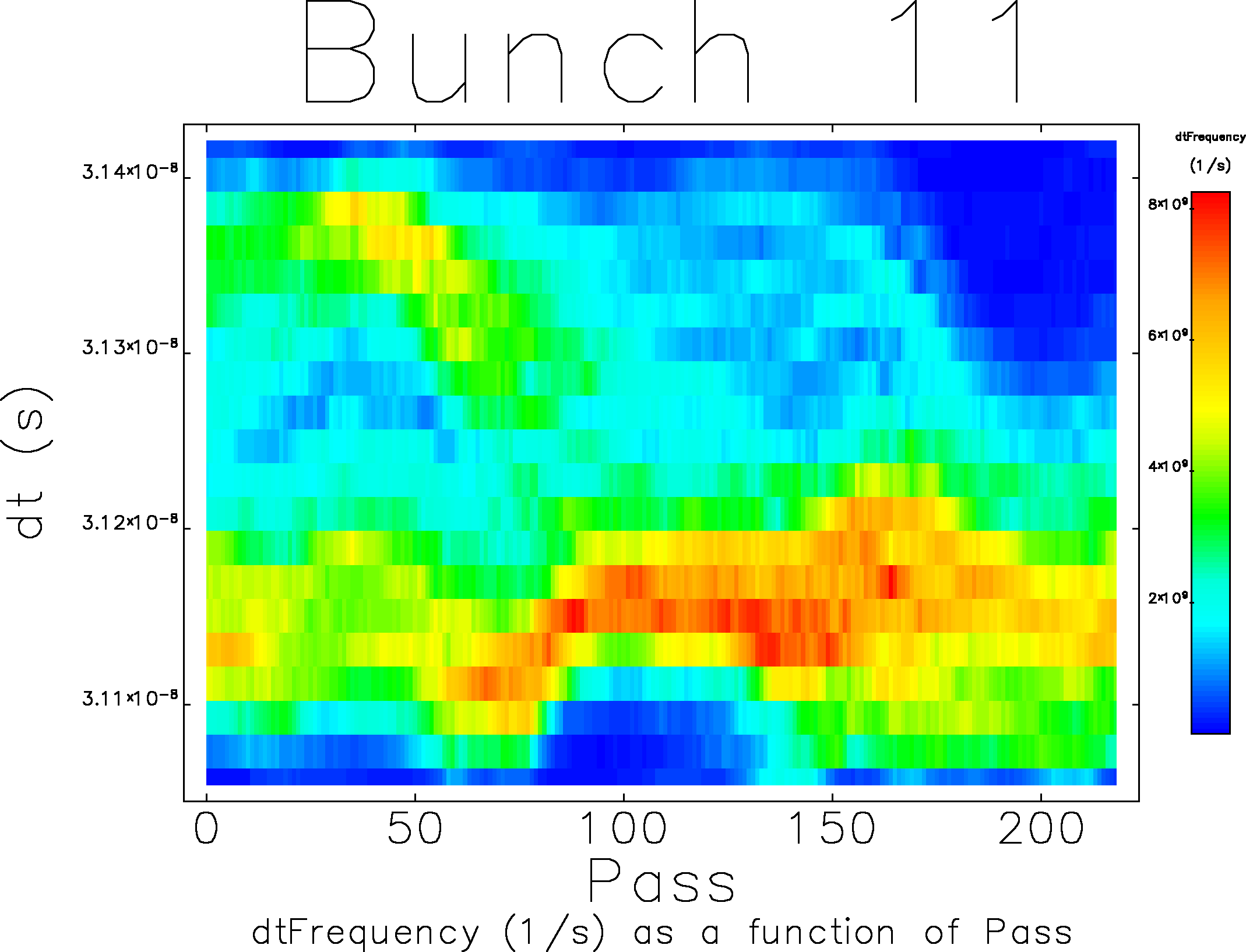

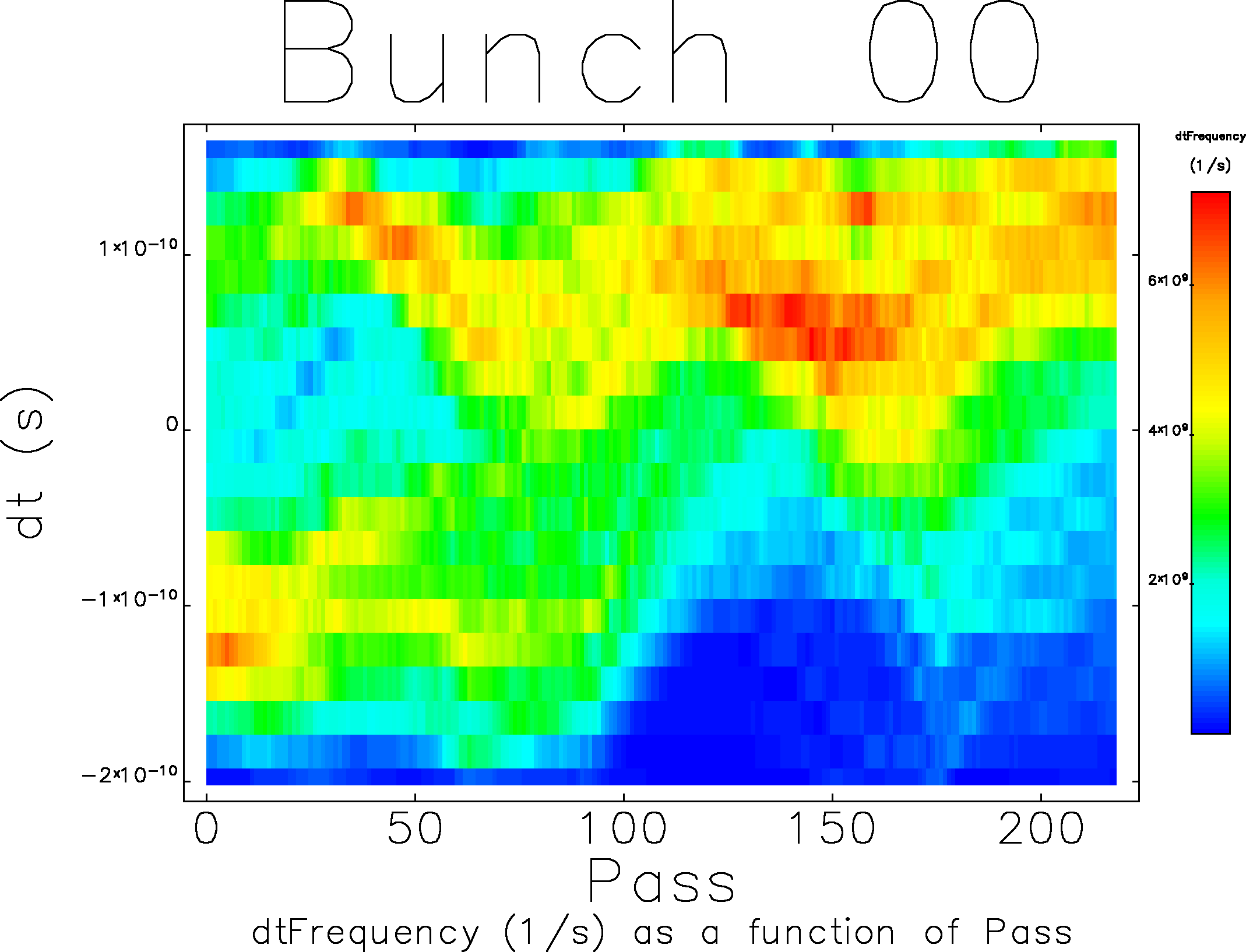

Please see the attached files, which show how to simulate 4 trains of 12 bunches with main and harmonic rf cavity beamloading.
Some sample output --Michael
