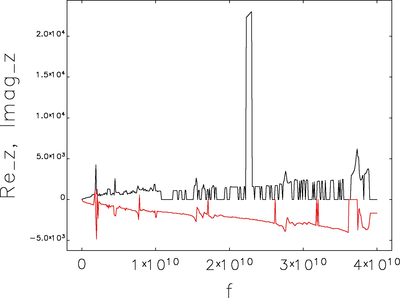

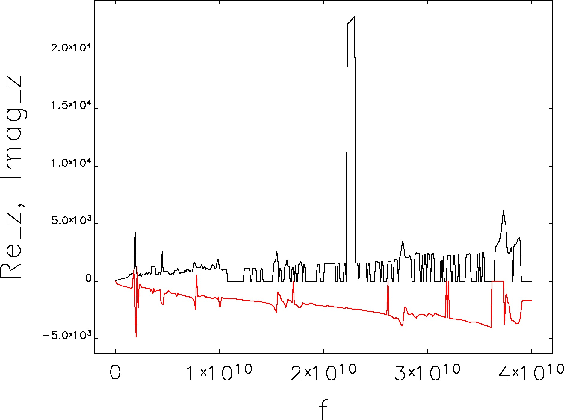

I am trying to make an sdds file for impedance (freq vs real part and imaginary part) using plaindata2sdds. In sdds file many of the rows were missing. I copied the data from data file and pasted in sdds file but during simulation I got error message "frequency values not equally spaced for real data(zlongit)". Please help me to understand this. Warning and sdds file are attached for the reference.

Your sdds file is a bit weird for me. The number which will be written in the first line of your txt file (before using the plaindata2sdds command) is the number of lines in your impedance txt file. This number must be equal to 2^n+1. If you fix this glitch, I think the elegant will run completely.

Something is definitely amiss with the file. When I run
it returns "corrupted".
The most obvious problem, as Mina points out, is the row count. I changed this from 257 to 400, which made the file valid at least. However, after plotting the impedance, I'd have to say something still looks off.
Perhaps you can post the original file (prior to running plaindata2sdds) along with the commandline used for conversion.
