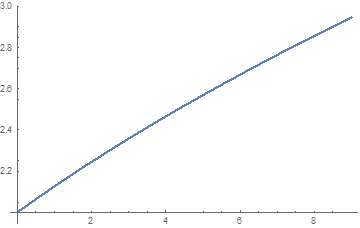

Can anybody tell me why theory prediction does not match the calculations?
Thank you.
Petr

After a single IBS at 9 meter position, my relative energy spread increases from 1.33e-5 to 1.58e-5, which I can match to Zhirong’s formula (https://www.slac.stanford.edu/pubs/slac ... 05-026.pdf) if Coulomb Log=2.91, which corresponds to 10^-6 relative energy change cut-off in the core of the distribution.

I have compared the simulation results with Eq. 9 of Zhirong's paper and the new code produces result similar to the theoretical prediction if Coulomb Log=3.44, which corresponds to 1.6e-3 relative energy change cut-off in the core of the distribution! Thank you.
I however have an issue with the new code. It produces an empty output when I use the following lattice while it worked before.

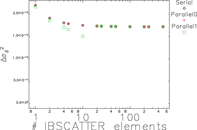

I found another problem with the code when used with Pelegant. This can be avoided by setting PARALLEL_INTEGRATION=0 on the IBSCATTER elements. I'll fix this in the next release.
You can see the problem in the results of my convergence test, where I propagate a beam in a drift with varying numbers of IBS elements. The "Parallel1" case (PARALLEL_INTEGRATION=1) shows strange convergence behavior.
