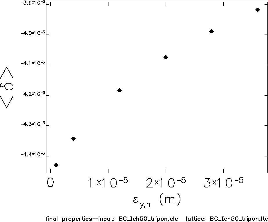

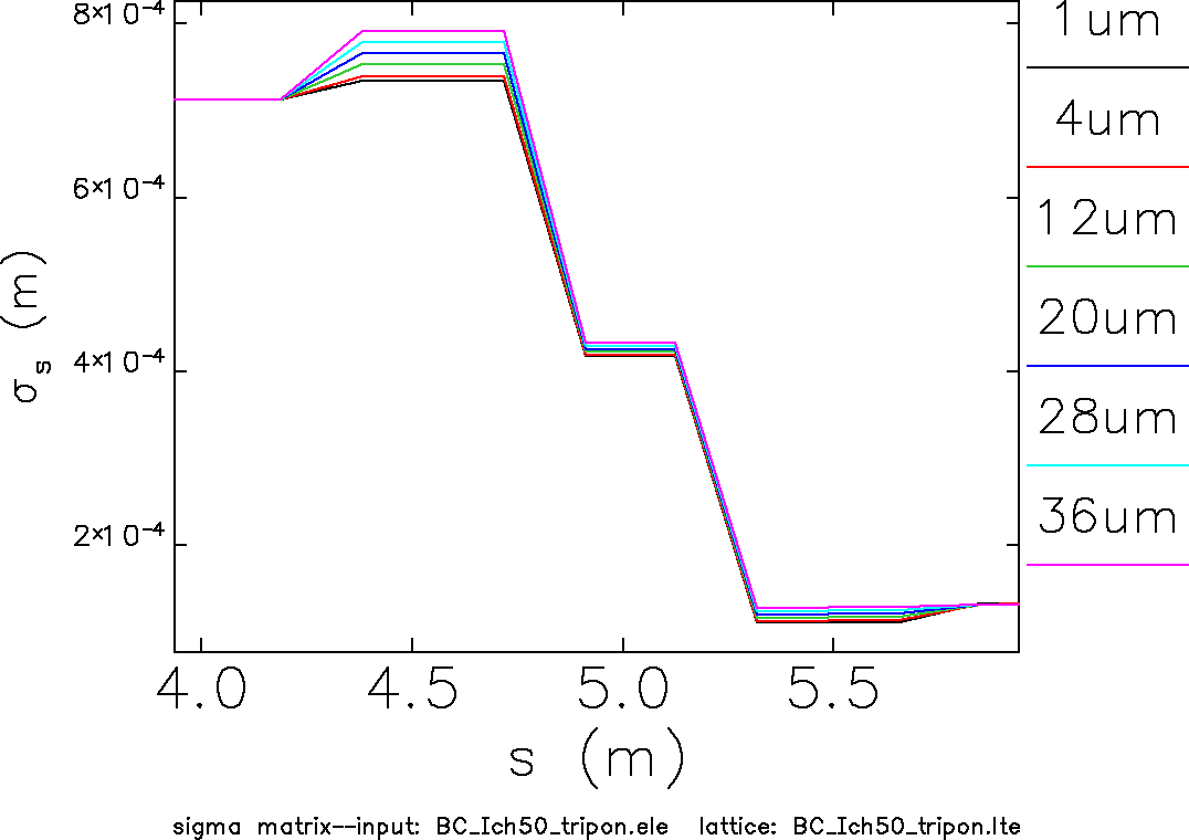

I confirmed this effect, as shown in the second plot, where I plot the momentum offset vs the emittance (x and y emittances are the same).
I'm pretty sure this is a result of the variation of the bunch length in the chicane dipoles as the emittance is varied. In the other plot, I show bunch length for several different emittances. For lower emittance, the bunch length is shorter in the dipoles, which leads to a stronger CSR effect. This agrees with the observed variation in energy loss with emittance.
