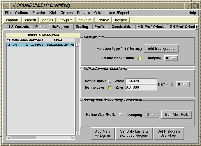

Now that the unit cell parameters have been fit, it is now
a good idea to also refine the diffractometer zero correction.
The diffractometer zero correction refinement flag is found on the
histogram panel, as seen below. Click on the check box for the zero correction
near the middle of the window to refine the parameter.

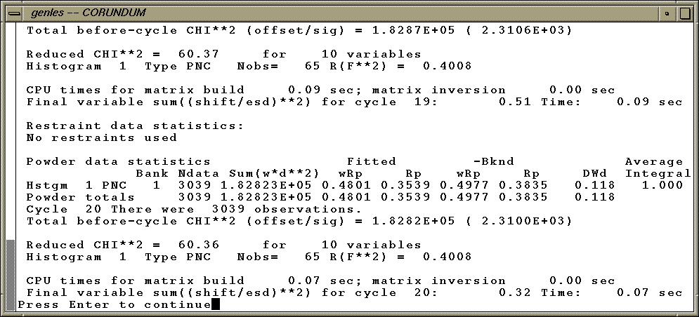

When GENLES is run, as shown below, a small but significant improvement is
seen in the agreement factors.

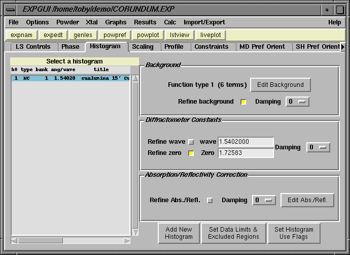

Note that the zero correction has refined from the starting value of 0.04
(0.0004 degrees two-theta) to 1.73 (0.0173 degrees two-theta). This small
correction is needed to obtain a good fit and accurate lattice parameters.
