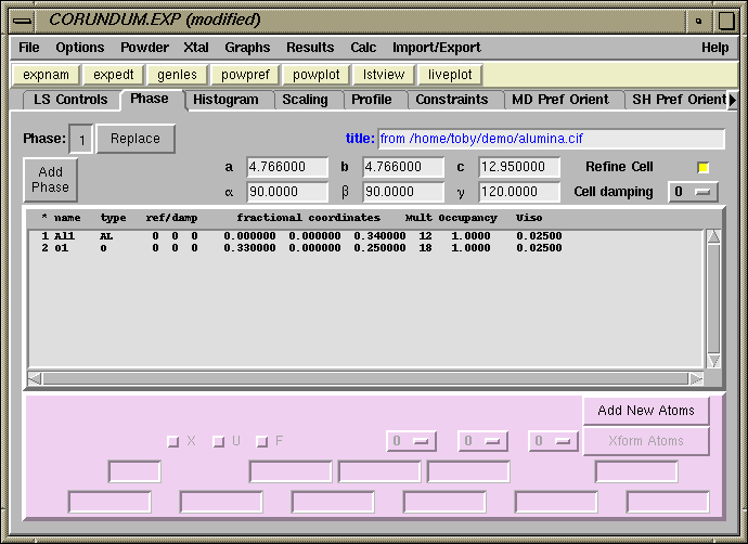

One the Phase panel, turn on the flag to refine the unit cell parameters
(upper right), as shown below.

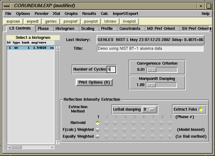

Also, increase the number of cycles to 6.

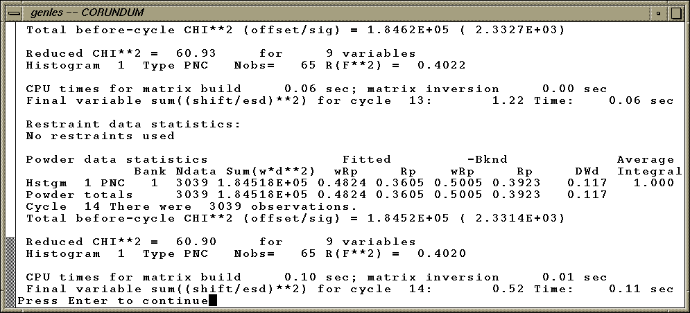

Run GENLES (as before). Note there are now 9 parameters
(scale, 6 background, + 2 cell) and that the fit significantly improves, as
seen below.
(As before, press Enter & load the modified experiment file into EXPGUI.)

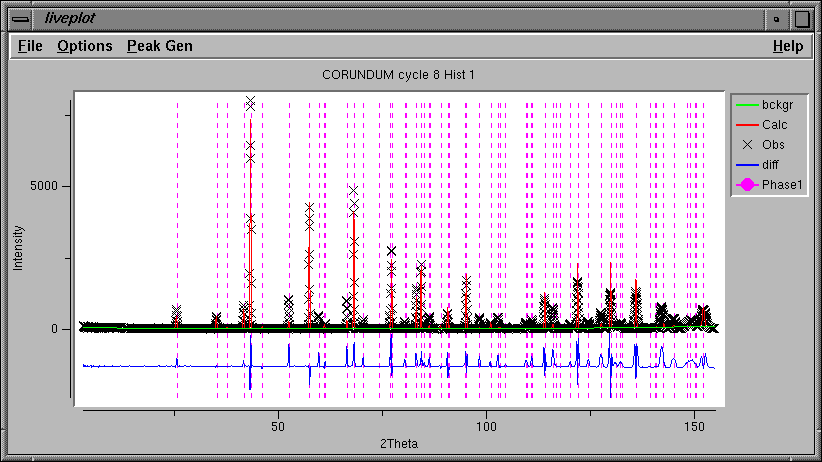

The peak positions are fit much better than before, as seen in the LIVEPLOT
output below.

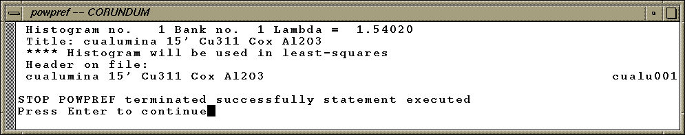

Since the peak positions have changed significantly, we now need to rerun
POWPREF and use the new peak positions to decide which data points need
to be indexed with each reflection.
It is not strictly necessary to run GENLES again, but note that CHI-squared
improves from 70 to 60 just from the better indexing.
