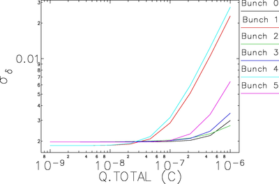

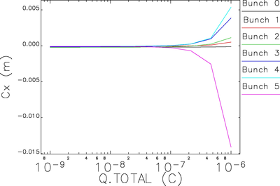

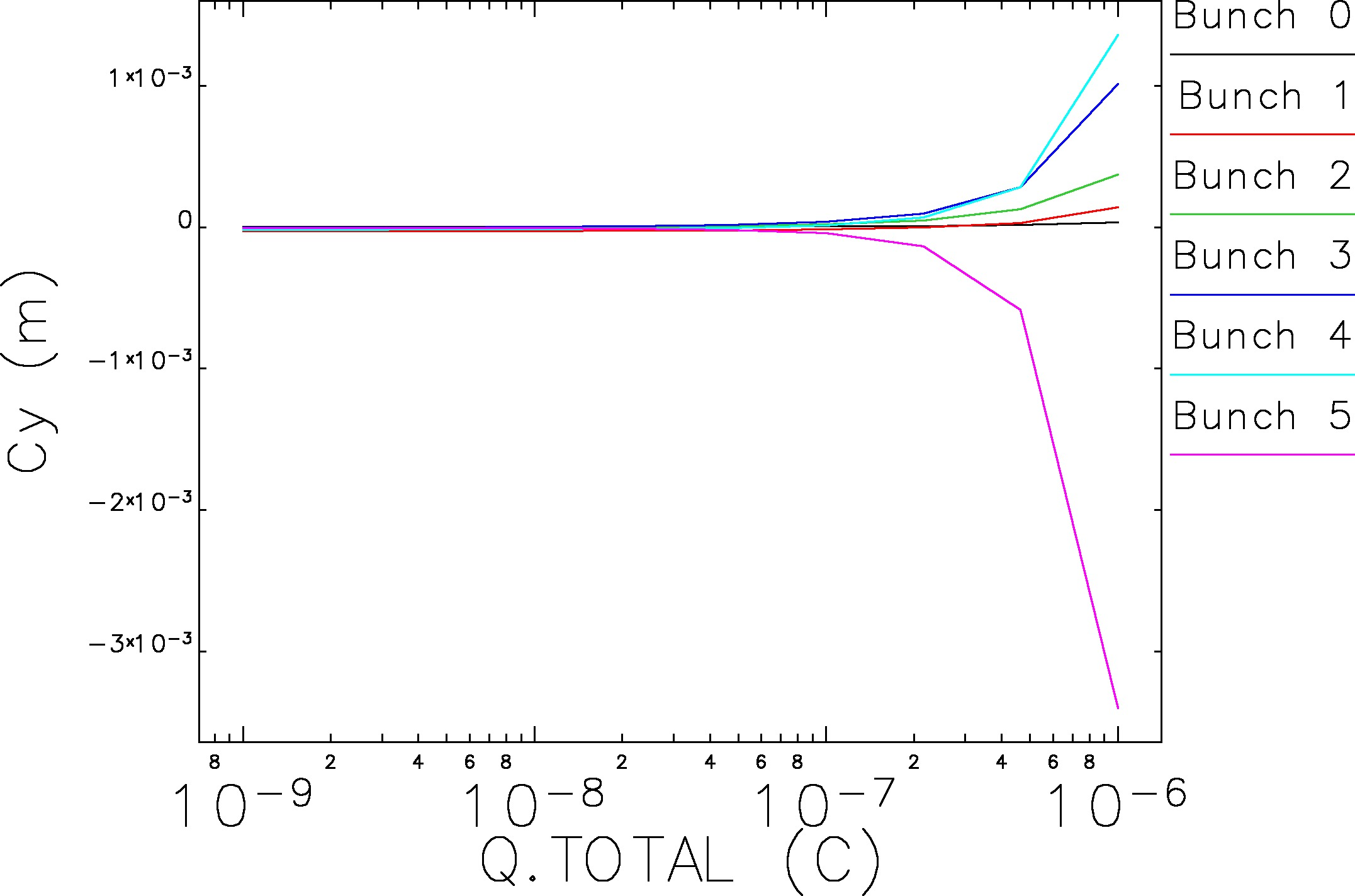

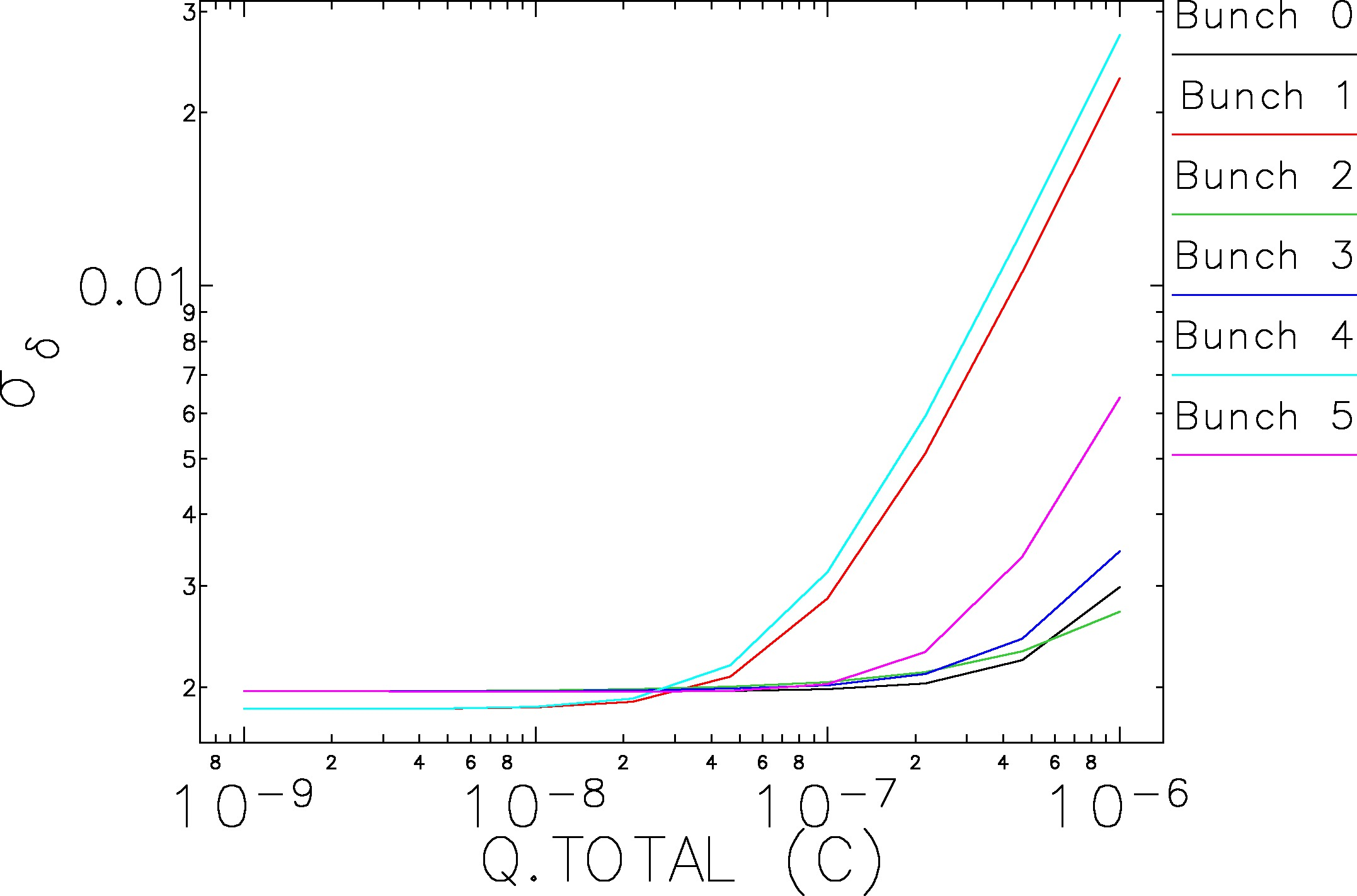

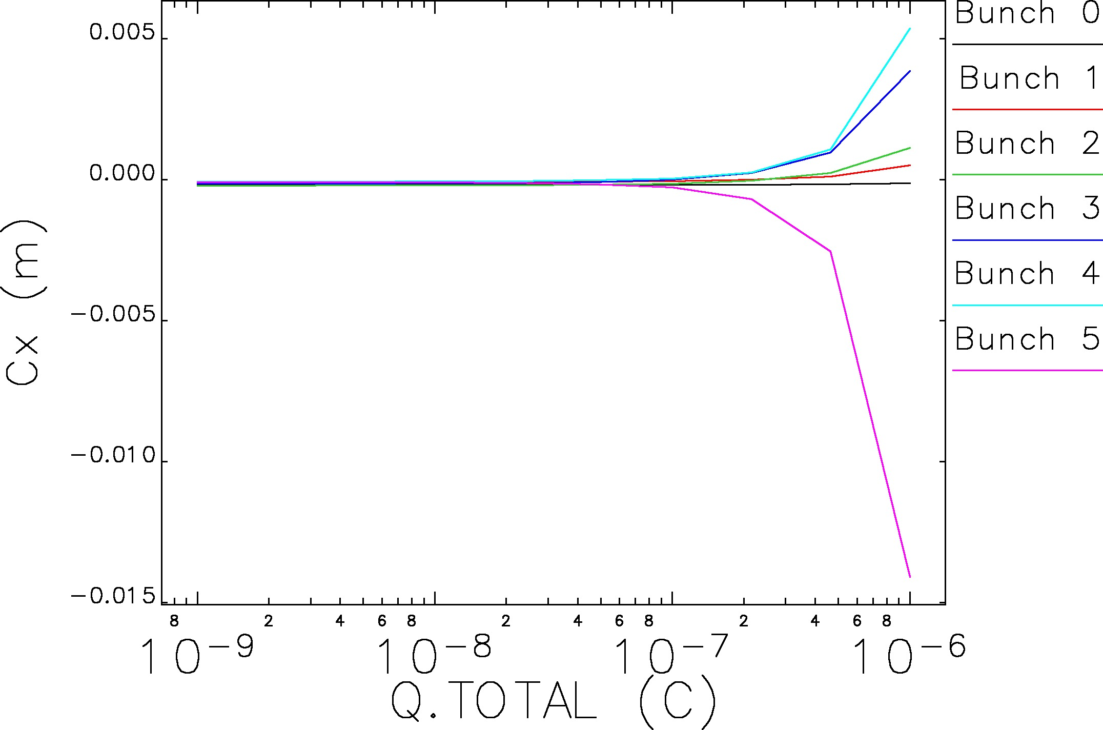

See the attached example, which uses the pattern you described to simulate beam breakup as a function of total charge.
