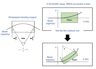

Hello, I would like to ask you about the bending dipole magnet setting in ELEGANT.
For the rectangular bending dipole magnet (Sben with edge angle), edge angle is half of the
bending angle, and the beam design entry/exit angles are also half of the bending angle.
Then, in the elegant setup for rectangular dipole using sben with has e1, e2 of half of bending angle,
I am wondering we could safely say that the bending dipole magnet itself is set with half of the bending angle towards the beam.
attachment=0]Rben_elegant__.png[/attachment]
Thank you!

Seongyeol,
Yes, that's correct: the RBEN element is symmetric, with equal entrance and exit angles.
