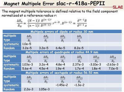

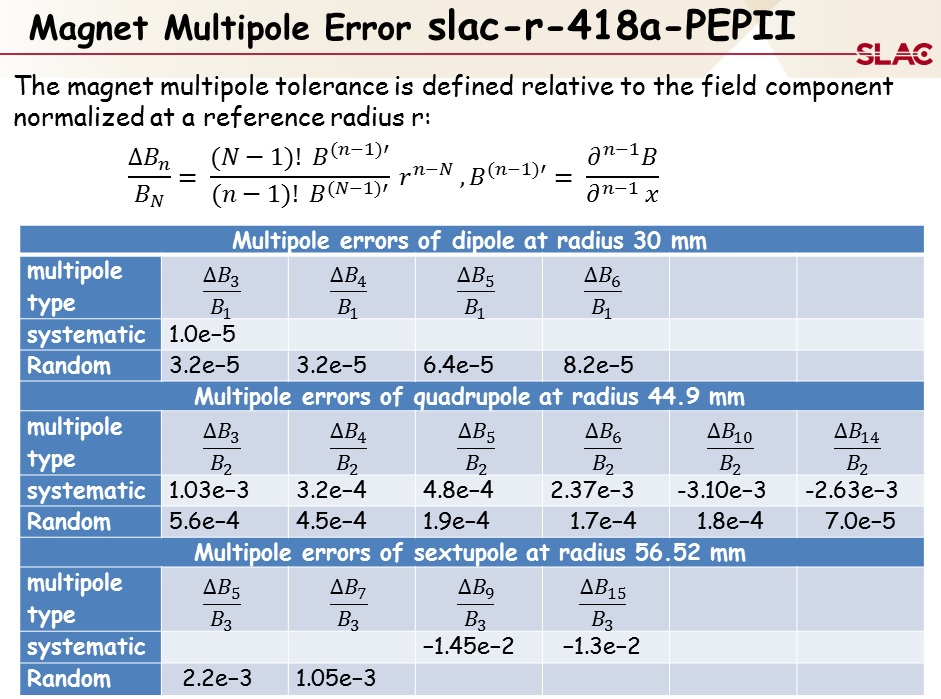

According to multiple error of PEP II,
and definition in ELEGANT, I made ELEGANT input as follow for Quadrupole and Sextupole

Here I list only systematic error for Quadrupole, it may be the similar case for others
Question 1: Am I right in this sdds file? it has two columns for order, and two columns for data
I am worry about the order may be wrong. And are the last two column for skew error?

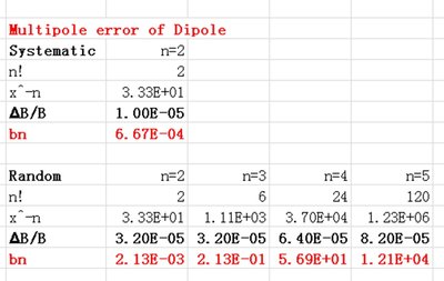

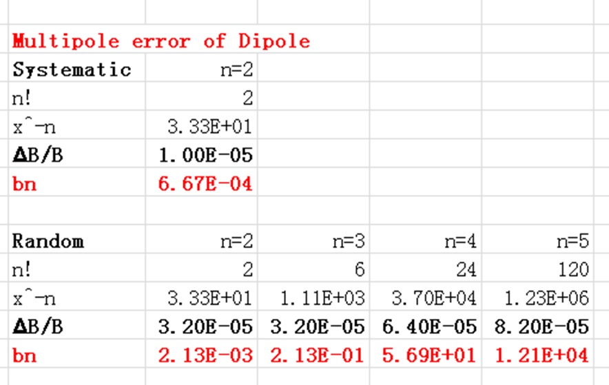

For Dipole, it seems a little complicated, I calculated bn in ELEGANT
bn=n!*X^(-n)*(∆B)/B Then for dipole of CSBEND
BXAF: CSBEND, L=8, ANGLE=0.07333499518, TILT=0, &
E1=0.0, E2=0.0, K1=0.0, B2=0.000667, N_KICKS=20
&error_element name=B*, element_type=*BEN*, item=B2, amplitude=2.13e-3, type="gaussian", cutoff=3.0, after=MERRORSTART, before=MERRORSTOP,
bind=0, fractional=0, additive=1 &end
&error_element name=B*, element_type=*BEN*, item=B3, amplitude=2.13e-1, type="gaussian", cutoff=3.0, after=MERRORSTART, before=MERRORSTOP,
&error_element name=B*, element_type=*BEN*, item=B4, amplitude=5.69e+1, type="gaussian", cutoff=3.0, after=MERRORSTART, before=MERRORSTOP,
&error_element name=B*, element_type=*BEN*, item=B5, amplitude=1.21e+4, type="gaussian", cutoff=3.0, after=MERRORSTART, before=MERRORSTOP,
Question 2: Am I right for those systematic and random error for CSBEND?

The dipole setup looks correct. At least the equation is correct. I didn't check the actual values. You may also use "f2", "f3", "f4", ... instead of "b2", "b3", ..., provided you give a value for the XREFERENCE parameter. This avoids the need to translate the values.
