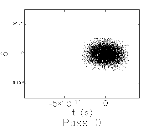

Re: CSR instability
I used Pelegant on one of our computer clusters at APS to perform a simulation for ~100 turns (actually only 93 as I inadvertently stopped the job). This took several days on 32 processors (I didn't keep track of exactly how long it ran.) The results are pretty interesting, as the attached animated GIF shows. This is an unshielded case, which is why it looks so dramatic.
We have a program here at APS that calculates the shielded CSR impedance. (We'll be distributing this with the next release of elegant.) An initial check using this (via the ZLONGIT element) shows no issues.
