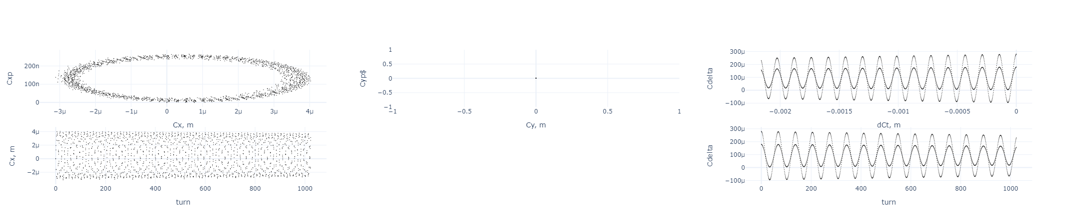

I am starting to use Elegant and as the first step I want to compare tracking results of Elegant and MADX.
Here are a lattice file, elegant script and a plot of phase trajectories for two particles.
I understand the calculated horizontal phase trajectories, damping is visible, but longitudinal trajectories are mystery.
Cdelta versus dCt should have been a closed curve (an ellipse), but it is not. I found several topics on forum and I think I did everything what was advised.
Am I using the wrong coordinates (Cdelta,dCt) for longitudinal motion? What variables should I use?

Regarding your first question, you can plot Cdelta vs. Ct to get the ellipse (spirally inward due to radiation damping) you expected. This is because you set "CHANGE_T=1" of the RF element, according to the manual, the time coordinates of the particles is modified to subtract off NTrf , where Ttf is the rf period and N = ⌊t∕Ttf + 0.5. Instead, if you set "CHANGE_T=0", then plottingg Cdelta vs dCt would get want you wanted.

So, if I use "centroid" mode of watch element and CHANGE_T=0 of RFCA then plotting Cdelta versus Ct does give me an ellipse. I tried it and it works.
