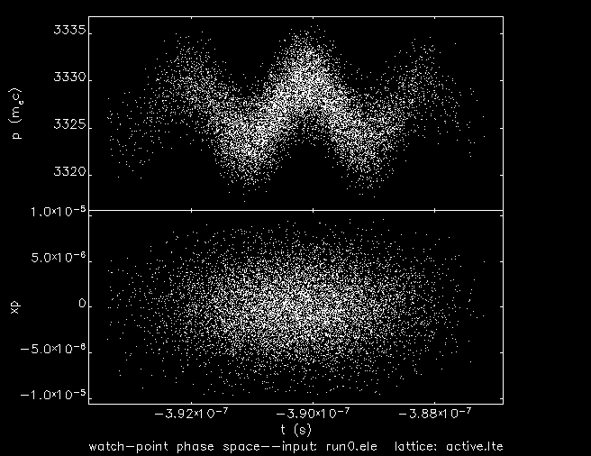

I would like to simulate the influence of time-dependant transverse-kick provided by a TM01 mode cavity with the presence of central orbit perturbation in a storage ring. Using paraxial approximation, a transverse electric-field exists and it is proportional to the beam offset as well as the beam arrival phase.
From the manual, it seems that the RFTMEZ0 element has an option for radial electric-field, RADIAL_ORDER.
But there is no real influence with different offset when I did simulations.
Do you have any suggestions for this simulation?

What I exactly want to try is that a phase-dependent kick by the cavity since the transverse electric field of a TM01 cavity depends not only on a beam offset but also on the cavity phase. But there is no clear correlation between t and xp when a tracking simulation has been performed with a long bunch.

Perhaps the effect is hidden by the beam size and divergence. When I try this with a single particle, the results are as expected.

I have checked that again and found that the kick effect is smaller than the initial angular distribution.
