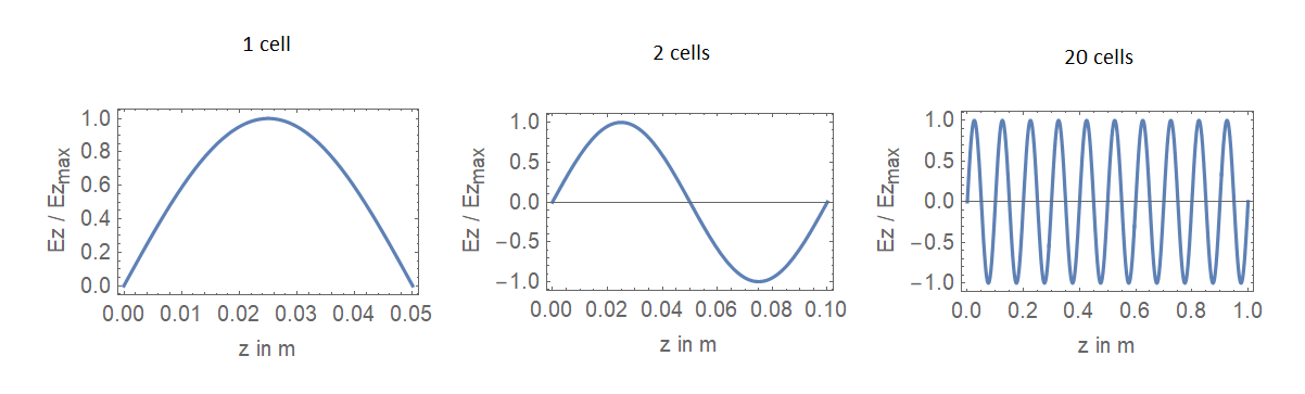

I want to work with the element RFTMEZ0 in order to investigate the phase slippage and to find the perfect acceleration process.
I noticed the following, what I do not understand: the on-crest phase seems to be dependent on the number of used cells (or cavity length). We use 20-cell Tesla-like cavities that are operated in pi-mode. To understand the element RFTMEZ0, I imported a 20-cell field map, a 2-cell field map and a 1-cell field map. They are simple test functions in the shape of 10 or 1 or 1/2 sine, respectively, as visualized in the picture. One cell is 0.05 m, hence 2 cells are 0.1 m and 20 cells are 1 m.
I used 10000 discrete points at each time, so the step size changes in the sdds files. The phase I have to adjust to accelerate on-crest depends on the number of cells (or the cavity length):
20-cell cavity: PHASE = 180°
2-cell cavity: PHASE = 0°
1-cell cavity: PHASE = 270°
(I converted the phases to rad in the lattice file).
Why is there a dependency on the number of cells (or on the cavity length) and what is the functional relationship?

Felix,
The issue is that RFTMEZ0 has set up the phasing of the fields before it performs integration. It does this by assuming that the fields reach their peak when the *drifting* particle reaches the center of the element. This results in a ~180-degree phase difference between your 2-cell and 20-cell cases, because the difference in the location of the phasing point is an odd number of cells.
It's also important to realize that when you have multiple RFTMEZ0 elements, they'll get independently phased unless you specify that they have a common phase reference using the PHASE_REFERENCE parameter. If the elements are part of the same physical element, it is essential to do this.
In the end, the best approach is to perform a preliminary scan or optimization to find the phase for maximum acceleration. The attached files show how to do this.
