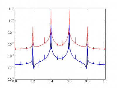

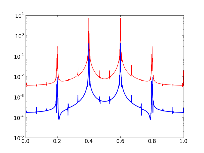

lyyang
Posts: 7
Joined: 09 Dec 2009, 17:51
Re: Compare the result of the frequency map with AT
Post by lyyang » 04 Oct 2010, 10:08
Hi,
In my opinion, it is very difficult to identify the right tune in every case, especially when there is coupling and lattice errors. The highest peak of spectrum does not mean it is the tune.
In the attachment, is the spectrum of x and y coordinate, 2048 turns, and the initial amplitude of x is ten times of y. The red is horizontal. The lattice I was using has various roll/misalignment errors. So the horizontal and vertical have identical frequency due to the coupling. But the power(height of the spectrum) are different.
Can you guess the true tune ? or the zero-amplitude twiss tune ? it is (.40, .33). the nux=.40 has no doubt. But please take a look at vertical tune around .33, the peak is so weak.
Of course we can apply different intelligence to identify the true tunes, but in general it is not easy to find a set of rules which applies to all cases. e.g. we can narrow down the tune range, but at high chromaticity it does not work well for the plots in x-dp/p plane.
Lingyun
Post by michael_borland » 04 Oct 2010, 12:04
Lingyun,
This is a very good point and a nice illustration of how difficult it is to determine the tunes when there is coupling.
Some years ago, I added tracking-based computation of tune shift with amplitude and tune footprint, as a way to perform optimization of nonlinear properties of rings. It failed for just the reason you describe. When the amplitude got large, it was hard to determine the tunes, but it is the large amplitudes that we are most interested in.
