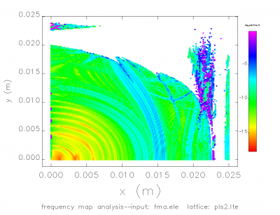

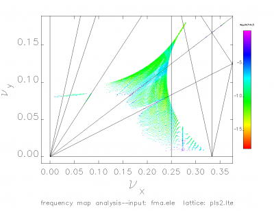

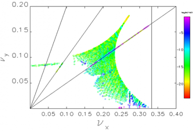

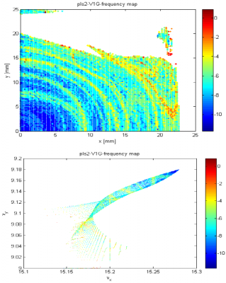

Thesedays I simulate the frequency map in PLS-II. But result of elegant is diifferent with AT.
So, I want to know the reason of the difference. I attached the file of the result of elegant and AT.
Which thing make the difference? :)
If someone know the reason, Please let me know
Sincerely yours.

Ji-Gwang,
I used your lattice to compute the FMA and post it here. In general, it is hard to say why one program disagrees with another. It's helpful to study the different parameters of each element, such as number of kicks, integration order, and edge effects.
I used more kicks in the elements (24 instead of 10), plus finer spacing of the grid points and a one-sided x scan.

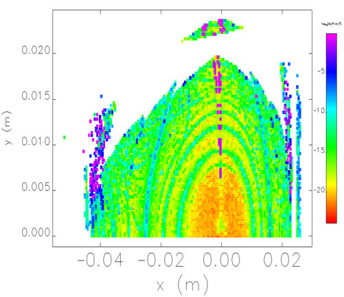

These result has some purple color at the center of horizontal plane.
Maybe the purple color means the particle has very large tune shuft.
I think it is come from 3rd resonance line. Is it corrected? and Is it fine to operation?
I want to know your opinion about effect of purple lines at the center of x-plane.
I simulate the FMA examples with 1000 turns in elegant example directory . But it has also purple line at the center of horizontal plane. So, It look like bug.

Ji-Gwang,
Sorry I didn't see this sooner. The purple color does mean a very large tune-shift, but it is not physical. This happens when the x amplitude is small but the y amplitude is large. Nonlinear coupling between the planes gives motion that doesn't have a clearly defined frequency.
A few possible fixes:
* Use fewer turns. This will be make it more likely that the NAFF algorithm sees the same motion for the first and second half of the tracking data.
* Change the grid size. You may be able to avoid the problem region, which is often very thin, but changing the grid size. If the x range is symmetric, try an even number of grid points. If x_min is very close to zero, try to increase it somewhat.
My run input files are attached. I used Pelegant on an 8-core computer to make it faster.
