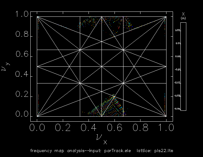

Hwang, Ji-Gwang
- Posts: 42
- Joined: 21 Jan 2010, 02:27
Re: frequency map analysis
Dear Michael Borland
Thank you for your kind reply. Your reply is very helpful for me.
I get the some result. So, I attached it.
But, I still have one question.
In the figure of result, One point aroud nux=0.9, nuy=0.3 is very far from order points.
I don't know that what means of this point?
I attached other result of FMA get from PLS. This figure look like strange at near the nux=0 and nux=1.
It is right result?
From Hwang, Ji-Gwang
It is right result?
- Posts: 2063
Ji-Gwang,
The particle with strange tune values is probably near a coupling resonance. If the x and y motion is strongly coupled, it can be difficult for the algorithm to find both tunes. It looks like the x tune got misidentified in that case.
Your results for PLS show a lot of tune shift with amplitude. The clumping around the 0 and 1 tune lines is probably from particles that are nearly unstable. By the way, I think you need the -order=spect option on your plots to get proper color-coding.
To say more I'd have to see your lattice file.

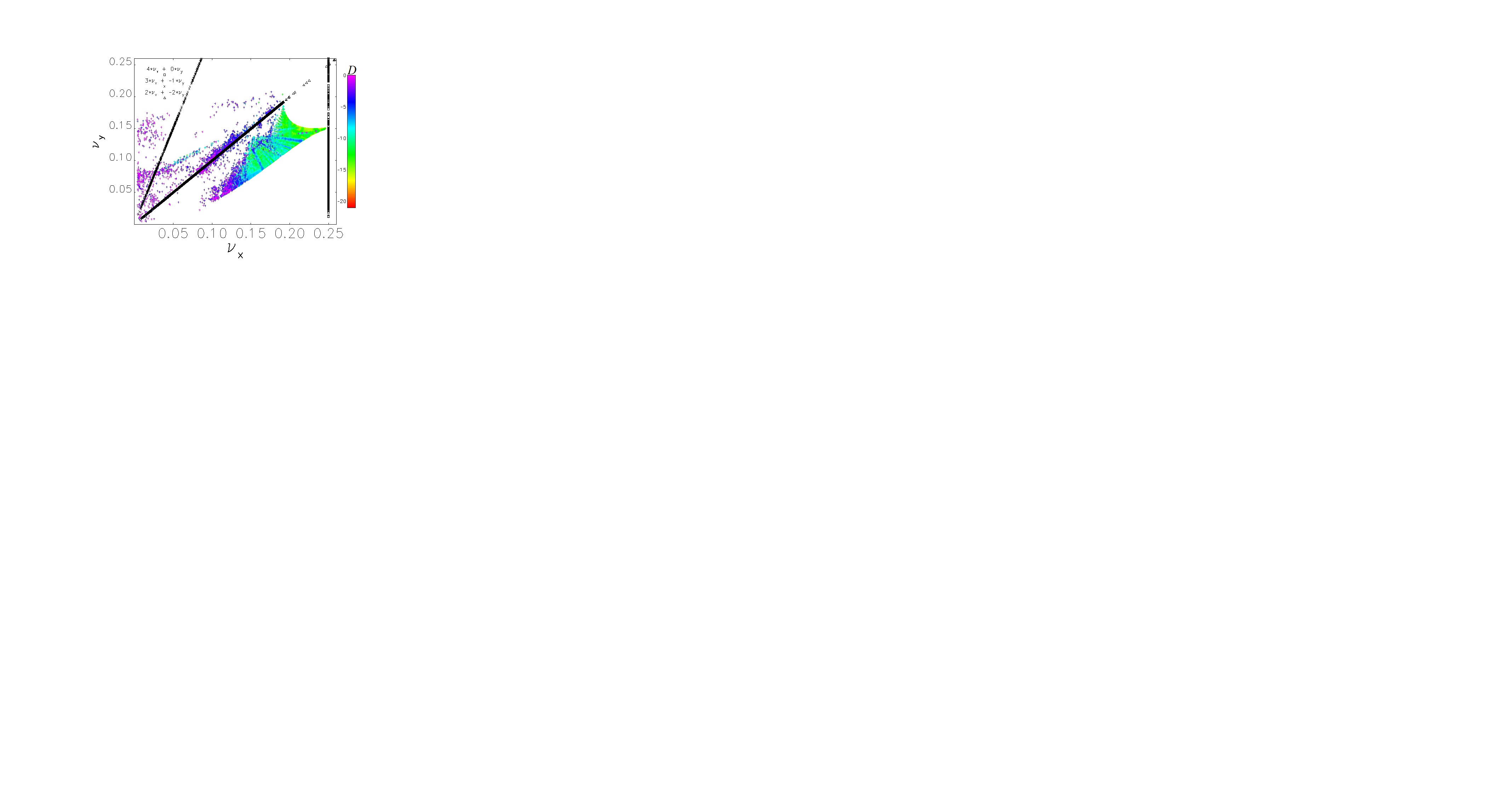

Hi everyone,
1- Is there a solution for resdiag to plot n-superperiodicity?
Example: My work has a 10 superperiodicity and tunes are nux=27.25, nuy=12.15.
After run, I got a plot like an attachment file. I read an information that is "The coordinate values are between 0 and 1. The defaults are [0.15, 0.9]x[0.15, 0.9]. in sddsplot manual for controlling the plotting region."
2- What is the main difference between &frequency_map and &tune_footprint?
Best regards,
Kahraman.
Dear Michael,
First of all, thanks a lot for your reply.
I recognized the relation between &frequency_map and &tune_footprint. I figured out it, well. But I have a question to get more clear related with the calculation of the frequency_map. What is the background of it? I guess it runs for n-superperiodicity (full ring), doesn't it?
I am not sure because the plotting of the results of the .fma and .res files is, as if it is one superperiodicity in tune diagram. Even though we simulate it for n-superperiodicity, the resonances which are in one superperiodicity condition are still shown in graphics. See an example a few 4 th order resonances in attach file. Actually, we can see that these resonances are not effective for this example.
Best regards,
Kahraman.
