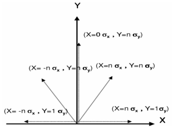

Hello, Michael, and other experts,
Usually we make dynamic aperture line survey as shown in follow figure. And we can use like follow words to get the dynamic aperture for the line (X= n*sigma_x, Y=n*sigma_y), (X= -n*sigma_x, Y=n*sigma_y)
and (X= 0*sigma_x, Y=n*sigma_y).

But for the line (X= n*sigma_x, Y=1*sigma_y), I don't know how to make the dynamic aperture scan.
And when I make a scan with the line (X= n*sigma_x, Y=0*sigma_y), I can only get a result of NO 3 of follow figures which is not enough. Thank you.

Guohui,
If I understand correctly, you want to set the initial y coordinate to a fixed value and scan the x coordinate to find the aperture. You can do this by simply creating a line of particles in phase space, e.g.,
In addition, in the &run_setup command, you should request the acceptance output:
The .acc file will contain the initial coordinates of all particles that survive tracking, which is the aperture in this case.
