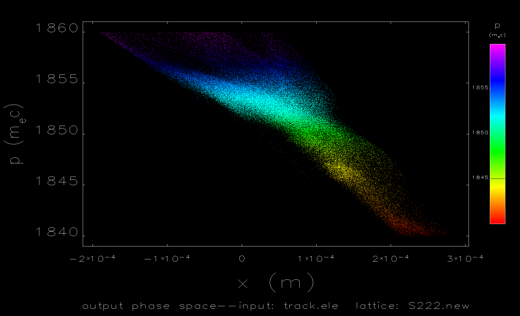

Hi Michael,
I am trying to reduce the x-slice energy spread at the end of the beam line. I am using dipole to disperse the beam but due to the beam large energy spread (or any other reason) the x-slice energy spread is too large for the TGU. I am using sextupole to reduce transverse emittances and getting linear chirp (x-p). I have attached the final x-p phase space. I am not sure that it is the best way to reduce the x-slice ES. I was wondering if there is another way to do that.
