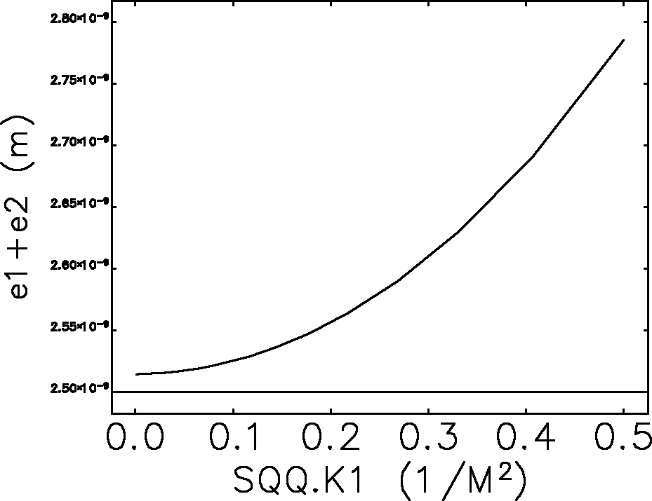

Chongchong,
I plotted e1+e2 vs the skew quad strength. I naively expect it to be constant and equal to ex0. As you can see, it isn't exactly constant. I think this is a result of the dispersion function getting mismatched as the skew quadrupole gets strong.
In the paper you cited, the reason injection efficiency suffers as the initial emittance ratio is increased is that this corresponds to faster exchange of oscillations between the x and y planes. That means the horizontal oscillations (from the large horizontal emittance and residual centroid) gets coupled into the vertical plane too quickly, before it damps out. Injection into a machine on the coupling resonance is possible, but it's important to make the coupling strength sufficiently weak.
