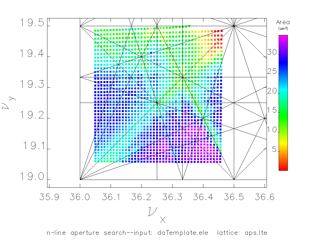

Attached are some files to demonstrate performing a tune scan to optimize dynamic aperture. The scripts work on linux, but may require modification to work on Windows.
Also attached is a plot showing what the result looks like.
A word of caution: this analyzes only the dynamic aperture. The momentum aperture will also vary with tune. A proper lattice design has to compromise between the two of these.
