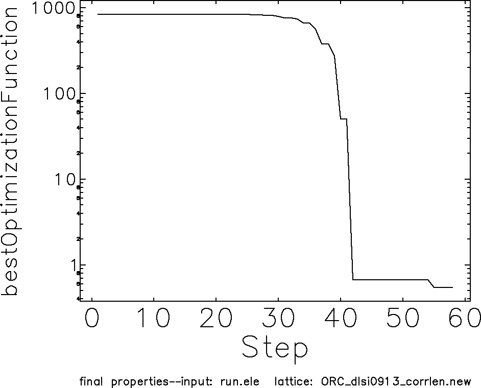

Re: error on optimization
thanks Michael
I have followed your advice, put the marker, and tried to evaluate the s11,s12 etc. terms at that point.
However MRK#1.s11 is not found, while for example MRK#1.s12 is. I have seen that moments_output saves
s1 rather than s11, so I have tried to see if I can access that term unsuccessfully.
In general I am not sure which variables I can use to define an optimization term. Is there a general rule?
Thanks
Marco
here the .ele + .lte file used for this case

- Posts: 2060
Marco,
Sorry, my previous message contained an error. The symbols to use are "s11m", "s22m", "s12m", etc. The extra "m" is to distinguish the &moments_output calculation results from the similar results from tracking.
You can find a more-or-less complete list of what's available for optimization by looking at the discussion of the "equation" parameter of the &optimization_setup command and also by looking at the documentation for the MARK element.
Attached is an example of a simulation that runs based on your files. I had to allow stronger skew quads to get convergence. I also adjusted the &optimization_setup command and made one change in the lattice file.
