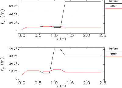

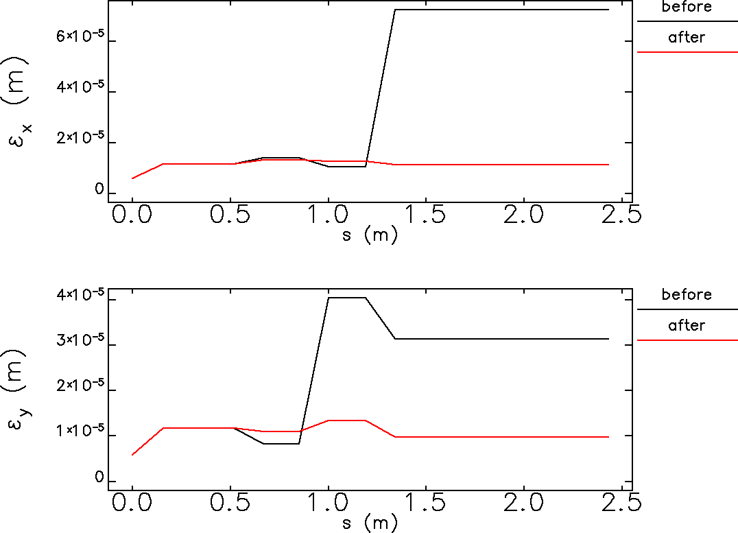

The .ele file I attached to my last message will optimize to less than 2x the target values. To go beyond that, you probably need more knobs. By adding the distances between elements as variables, I was able to get the growth down to 1.6x the target. (See attached.) Adding another quad or two might give better results. You can also try increasing n_restarts; sometimes this helps to find a better solution if you are willing to wait.
You are right that there may be an issue with computing the x and y emittances, since the problem is coupled. You can try adding to the simulation a minimization of the off-diagonal sigma matrix terms, i.e., s13, s14, s23, and s24. Again, to make much progress you may need more knobs (e.g., more quads). However, it is possible that you'll get into a problem of diminishing returns as you add more knobs, due to extra chromatic effects.
