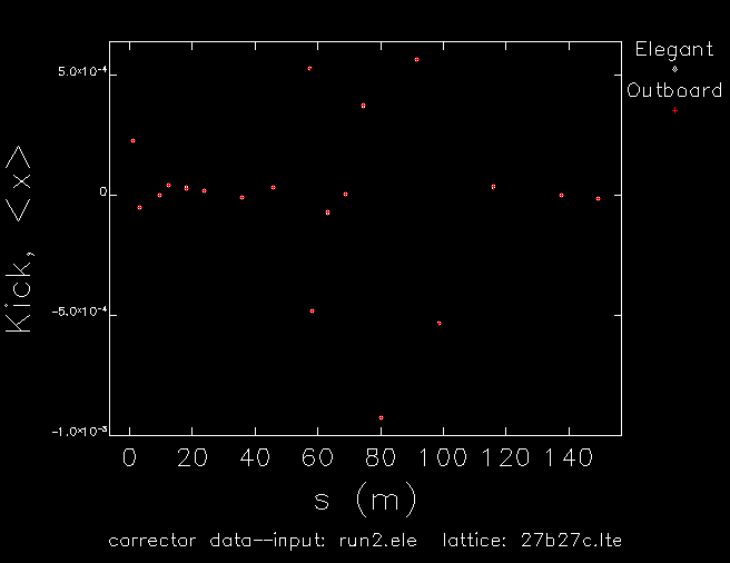

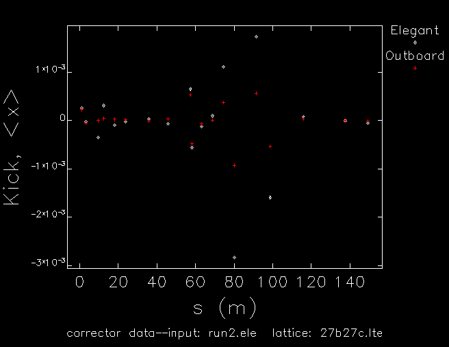

simone.dimitri
- Posts: 46
- Joined: 09 Jun 2008, 01:19
Re: Closed Orbit Correction Fails to Work
Hi Michael,
thank you for the examples. I have applied your script to my lattice and I have found the source of the discrepancy.
When I do not include errors on the BPM alignment, everything is fine (see attachment bpm_noerr.png). But, as I also include these errors, the elegant response in terms of kicks is different from the response matrix prediction (see attachment bpm_err.png). The same happens as I include the bpm noise option in the &correct module.
So, I guess that when I run &correct, even with only BPM alignment error, elegant sees the beam offset at the monitors and try to correct it. But, at the same time, the beam position file .cen - generated with only errors included and no correction - multiplied by the transposed response matrix has 0 everywhere so that the resp. matrix multiplication does not predict any kick.
If I am right, now my question is: why &correct sees the beam offset at the BPM location, while everything is zero in the .cen file?
Am I missing something else?
S.

- Posts: 2051
Simone,
The reason for this is that all output from elegant that contains particle coordinates or moments of particle coordinates is created based on the particle coordinates measured relative to the reference trajectory. Since BPMs don't affect the reference trajectory, you won't see any effect from BPM errors in the .cen file.
Please see the attached file for a demo of how to get the BPM offsets and use them in the outboard trajectory correction.
