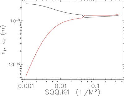

I've attached an example that may help. In this example, I tune the APS lattice to the difference resonance (nux=36.25, nuy=19.25), then vary the strength of a skew quadrupole. You can see how the emittances of the two transverse modes vary. One issue with these simulations is that elegant may misidentify the modes. In the above plot, you can see that it exchanges e1 and e2 as the skew quad gets stronger. In some cases, it may confuse the longitudinal mode for one of the transverse modes. So if e1 or e2 has a strange value, look at e3. I'm not sure why this happens but will look into it.

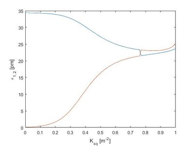

Question 1:Theoretically, e1=e2=(e10+e20)/2=17.5 pm when I tune the lattice to the difference resonance(where e10 and e20 are initial emittance respectively). But the results (Fig.1) show that e1=e2=23pm. Could you help me solve my problem?

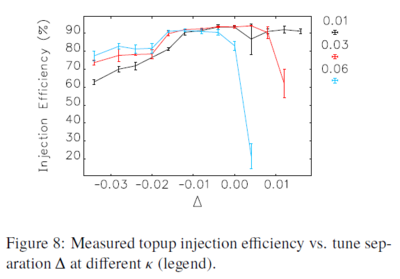

Question 2:In the paper EXPERIENCEWITH ROUND BEAM OPERATION AT THE ADVANCED PHOTON SOURCE, injection efficiency goes down significantly in the vicinity of the coupling resonance for the ratio of 6% as Fig.2 shows. I do not understand this phenomenon. Could you help me solve my problem? And whether injection efficiency can be simulated with elegant?

I plotted e1+e2 vs the skew quad strength. I naively expect it to be constant and equal to ex0. As you can see, it isn't exactly constant. I think this is a result of the dispersion function getting mismatched as the skew quadrupole gets strong. In the paper you cited, the reason injection efficiency suffers as the initial emittance ratio is increased is that this corresponds to faster exchange of oscillations between the x and y planes. That means the horizontal oscillations (from the large horizontal emittance and residual centroid) gets coupled into the vertical plane too quickly, before it damps out. Injection into a machine on the coupling resonance is possible, but it's important to make the coupling strength sufficiently weak.
