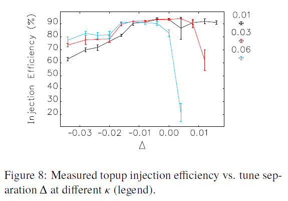

Question 2:In the paper EXPERIENCEWITH ROUND BEAM OPERATION AT THE ADVANCED PHOTON SOURCE, injection efficiency goes down significantly in the vicinity of the coupling resonance for the ratio of 6% as Fig.2 shows. I do not understand this phenomenon. Could you help me solve my problem? And whether injection efficiency can be simulated with elegant?

In the paper you cited, the reason injection efficiency suffers as the initial emittance ratio is increased is that this corresponds to faster exchange of oscillations between the x and y planes. That means the horizontal oscillations (from the large horizontal emittance and residual centroid) gets coupled into the vertical plane too quickly, before it damps out. Injection into a machine on the coupling resonance is possible, but it's important to make the coupling strength sufficiently weak.
