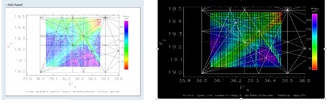

At first, I run the DATuneScan to benchmark against the picture in the above aps-forum link. I obtain the same result for the APS lattice, but looking more closely, something puzzles me a bit: when I extract the tunes from the files named "scan-tunex-tuney.twi", using a script called "plott" (because it also plot in addition of displaying parameters), I notice that the tune point do not match those indicated in the name of the file:

(below: left : Michael's plot, right: my plot from the example)

I think the problem is simply that the tunes are adjusted using a response matrix in a single step. As the tune change gets larger and as the tune approaches the integer and half-integer resonances, this will be inaccurate. That's why I plotted the results as a function of the actual tunes, rather than the desired tunes.
This can be improved by including tune correction in the daTemplate.ele file, using the correct_tunes command, to bring the tunes closer to the desired values.
