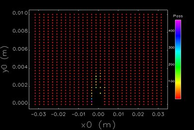

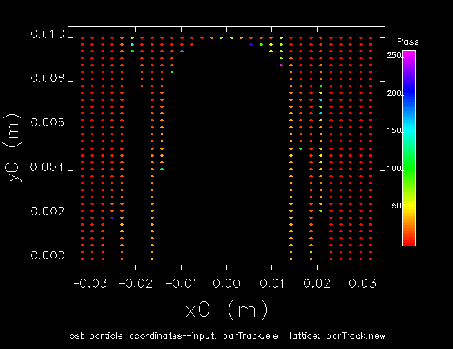

Another method is just to perform tracking with a beam that fills a large rectangle in x-y space. By using the losses parameter of the run_setup command, one can get a record of the lost particles and cross-reference to the initial coordinates using sddsxref (making use of the particleID data in the bunch output file and losses file). This allows making a map of the lost particles color-coded by the turn on which the loss occurs.
Attached are some files that demonstrate how to do this. The script elegantRingAnalysis allows doing this on a cluster, which gives very rapid turn-around.

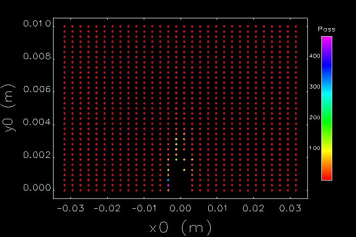

Hi,
I provided a plot for DA and it gives a result as it can be seen in attached file.
I am just wondering how I can make it with more points and colors?
Thank you,
Özgür
Thank you,
Özgür

Ozgur,
I think you want to zoom in on the DA boundary. If so, use the beam size controls on the &bunched_beam command, e.g., reduce the emittances specified by emit_x and emit_y.
Re: High-resolution dynamic aperture
Hi Micheal,
I also increased the particle number in addition changing the emit_x and emit_y and it worked, thank you.
Best,
Özgür
Best,
Özgür
