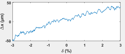

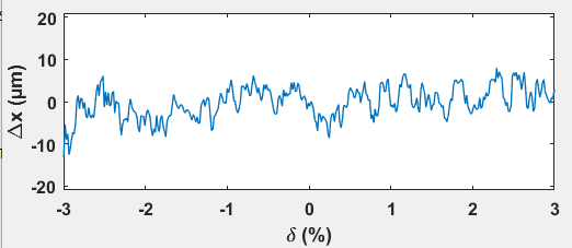

Regarding the offset, I'll attach two pictures showing the mean slice x-position as a function of energy spread (a bit noisy, but I just ran them quickly with not so many particles; the trend should show, though). The first one is with edge_effects = 1 and edge_order = 2, the second one with both those options = 2. In both cases, R16 = 0. Note the different scales. In the second one, there is a clear linear term and a weak second order one, as far as I can tell. I can email you a lattice file if that would help.
Oh, all right, it's user error on the tracking_matrix, I thought it was an on-off thing (i.e. just 1 and 0) and not the order that you were supposed to enter. I'll try that right away, but maybe it can be clarified a bit in the manual? I always run the default_order = 3, though. I'll give it another shot!

Please post the files you used to get the plots you posted showing a dispersive term. Is this for a single dipole, a chicane, ... ?
