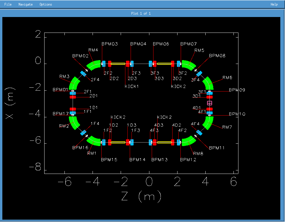

I figured out how to plot quite a nice picture of accelerator layout using floor_coordinates command in Elegant.
I hope somebody will also find this simple script useful.

new sddsplot options (for 2D lattice layout)

Re: new sddsplot options (for 2D lattice layout)
Alexey,
Thanks for posting this. I'm very impressed by how nice the plot is.
We'll certainly consider your suggestions (though some might not be so easy).
The edit=<command> feature on the -string option is meant to be used with the -string=@<parameterName> syntax. The idea is that if the string is taken from a parameter in the SDDS file (instead of being given explicitly on the commandline), then the user may want to automatically edit the string.
Thank you, Michael! I see the point now. This is the SDDS-edit, not the interactive edit as I expected.
Still, links + tcl-dialogs may add some interactivity into the sddsplot.
